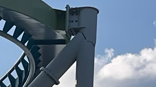

Carowinds Fury 325 2nd crack found in structure

Yikes. Gotta wonder if there's a design or manufacturing flaw at this point
Mistakes do happen and obviously something is wrong. It's interesting because B&M really is the top 1 or 2 designers in the world and all of their steel for North America is welded by the same shop outside Cincinnati. But who knows, maybe the shop inspector turned over during this fab.
The first one at least looked like a failed weld.
It may have started as a failed weld...but went bad quickly.
Yeah, it looks like the weld around the diagonal brace failed, once that happened it couldn't carry the lateral forces anymore and crack through horizontally from bending moment.
The amount of gap also (to me at least) indicates that either the track has yielded to the right, or the support column was preloaded when installed. Over that length being preloaded likely wouldn't matter, but it is possible the overall stresses were higher than designed because of it.

you can see which way the dynamic forces are sending it. I doubt it was preloaded, more like the thing failed under loading and the track has displaced that way.
