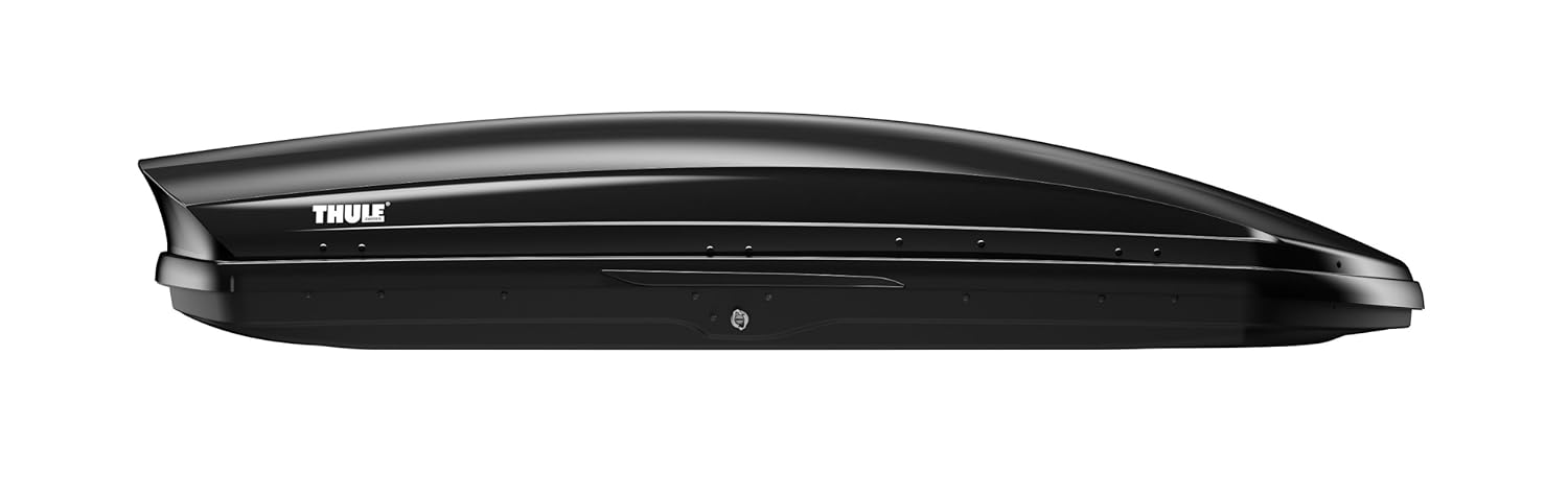

Look at his image, drag is reduced 7x when the pointy end is backwards. Car designers have to make several compromises when designed a car, and therefore can do a proper aerodynamic closure on the back end. I think what he was trying to show was that more aerodynamic cars taper their backends much more than say an SUV.
Here is another image that shows the wake behind a streamlined object and a more blunt object.
Notice that the flow separates at the rear of the more blunt end. But the flow doesn't separate at the front of either object. This is because when the air is being pushed out of the way in the front there is a favorable pressure gradient so it is able to follow much more blunt shapes. However, as the object passes and takes up less volume the air must fill this void, but it does so under an unfavorable pressure gradient, so the flow is much more likely to separate and cause a low pressure wake zone. This low pressure wake zone literally "sucks" the backside of object, causing pressure drag. This is why the back of semi trailers and SUV get so dirty, the low pressure area literally sucks dirt up there.
Also look at aerodynamic helmets:
Or wheel pants on a Cessna:
Manufacturers recommend a certain direction because that is what people think it should look like, not because they did extensive wind tunnel testing and provided the entire aerospace industry has been wrong for the last 100 years.
Now if you were driving supersonic, the pointed end should go in the front.

Patented AeroNose Design reduces drag and noise making it the most aerodynamic box available.
Thule must be using a wind tunnel.
But then it would be even better mounted backwards.
This sounds like a new Mythbusters episode.

Don't confuse a patent with proof for anything, or trust marketing claims without data. Now if they publish the CD, I'll believe that it went through wind tunnel testing (Out of all the brands, it wouldn't surprise me if Thule did do real testing)
This may be the real reason they put the flat end on the back: "Patented Rear-Angled Base and expanded vehicle mounting points help maximize trunk and hatch clearance"
So again, everything in life is a compromise.
Notice they do have a nice gently slope on the back, before they truncate it. This box turned around may perform worse since it would be sloped against the airstream and there would definitely be separation at the corner.
Now if you flipped it around and made a little round nose for it, it'd do great backwards ;).
