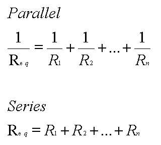

Okay here is what I am thinking:
Infinity Reference 1210a
854 watts RMS x 1 at 4 ohms (CEA-2006 Compliant)
1300 watts RMS x 1 at 2 ohms
Since I will be running 2 subs, do I cut these numbers in half to figure out how much power will be going to each sub?
2 Alpine Type R 12"
Dual 4-ohm voice coils
Frequency response: 24-500 Hz
Power handling: 50-500 watts RMS
Peak power: 1,500 watts
Yay or nay?
Also they have the 4 ohm version and the 2 ohm version. Which do I need?
95SS
Nov 30, 2003
1,630
If you're set on that amp, go with the dual 4 ohm subs. Wire the coils of each sub in series (8 ohm load), and wire the subs parallel to the amp (4 ohm final load). Those subs won't handle 650 watts each (if that spec is accurate).
