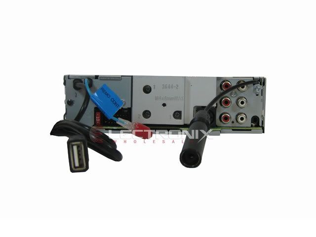

I'd like to get the Kenwood Excelon KDC-X693. Looks to be a pretty good head unit and get's pretty solid reviews from people.
