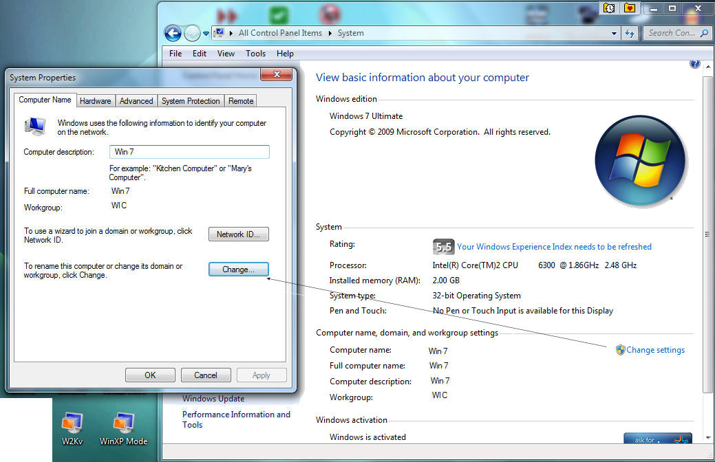

For best results log to each computer's System Screen and set all the computers to be on a Network with the same name while each computer has its own unique name.
http://www.ezlan.net/Win7/net_name.jpg

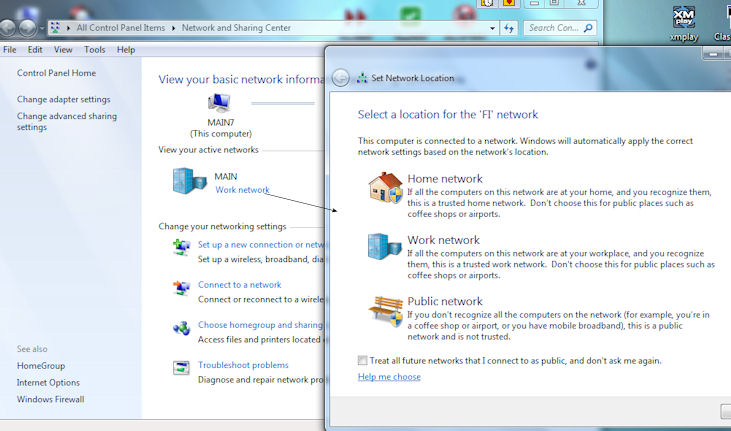

Networking Win 7 with other version of Windows as Work Network (works very well if all computers are Win 7 too).
In the Network Center, clicking on the Network type opens the window to the right.
Choose your type of Network. Notice the check mark at the bottom, and check/uncheck it according to your needs.
http://www.ezlan.net/Win7/net_type.jpg
