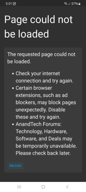

Question Can't access Anandtech or the forums via wi-fi
ch33zw1z
Nov 4, 2004
39,747
20,322
Cable into a Netgear modem with 2 ethernet outputs. One to the R8000 for wifi. One to the R7600 for an ethernet switch. Wifi has been turned off on that one for almost 2 years.Is the problem double NAT? I thought that only happened when you run from one router to another...with wifi turned on in both.
NONE of this explains why rhe problem started about 10:00 am yesterday. Everything has been hunky-dory until then.

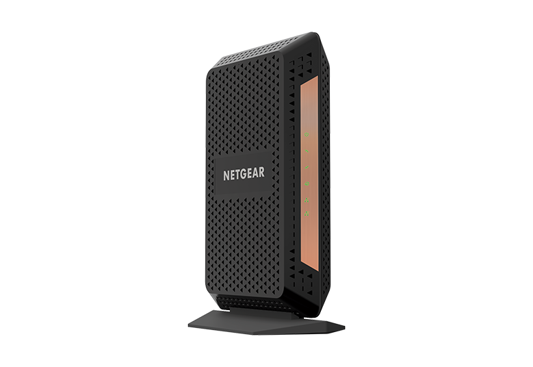

There are two (yellow) LAN ports on the back. Each one connects to a separate wifi router.
You're not supposed to connect two different routers to those ports, unless you're paying your ISP for two separate public IPs. Looks like they finally discovered your leaching, and cut you off.
ch33zw1z
Nov 4, 2004
39,747
20,322
Ok, basically your configuration should have never worked "correctly". It's dual port to support a router that can do LACP (Link Aggregation Control Protocol), which neither of yours can AFAIK.
Basically, one of your routers should be set to "primary", connected to the Modem. The other router, if you choose to use it, should be configured as "WAP" the way the EZLan link explains.
The link between the two routers should be LAN to LAN, do NOT use the WAN port on the secondary router. Set a manual IP on the secondary, something in the same subnet but outside the DHCP range, disable DHCP and DNS. You want the primary to drive, all requests from clients to go to it with no stops in between.
You should also be able to login to the Modem itself using 192.168.100.1 to see what's up.

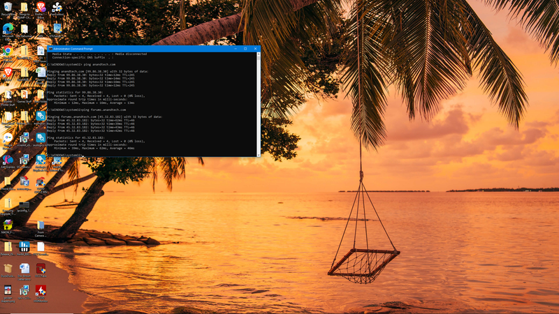

Use Windows Key + SHIFT + S to capture a window. Your full screenshot is completely blurry.
And what kind of errors you were getting when visiting www.anandtech.com and forums.anandtech.com?
lantis3
Oct 18, 2023
279
56
61
So no problem pinging the www and forums
Then what errors you were getting on the PC?
Try to clear browser cache (choose 7 days if you don't want to clear all) if you are using Chrome
