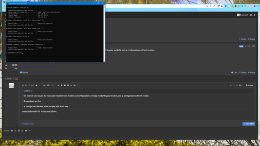

Ok, so I will now require the make and model of your modem and configuration (in bridge mode? Regular mode?), and ip configurations of both routers.
Screenshots are fine
Ip configs from devices while you play with it will help
make and model #'s in the post above.
ethernet connection via the R7600:
