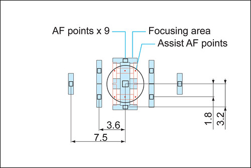

What camera body? If you have a Rebel or even an earlier XXD series body, the AF system isn't exactly top-notch...
Original 5D.
The center AF point on the 5D and 5D2 is a f/5.6 cross point, but it has 6 invisible (non-selectable) assist points. That makes it it more accurate and well suited to AI-Servo tracking. However, all the other AF points (the 8 other visible ones) are non-cross type, meaning they can only detect contrast in one direction (either horizontal or vertical, but not both). Most of the outer AF points on the 5D are laid out vertically, which means that they are insensitive to vertical contrast (for example, a vertical line in a room). If you rotate the camera into a portrait orientation, then 6 of the 8 outer points would be sensitive to vertical contrast, but not horizontal contrast.
If you are using AI-Servo, try locking the AF to the center point. The 6 invisible assist points should help the camera track in AI-servo mode.
Above is the AF point layout for the 5D. You can see that the outer 8 AF points are only sensitive in one axis.
