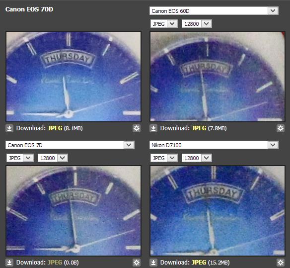

Canon 70D, 60D, 7D, and Nikon 7100 noise test.

It look like Canon have something to counter Sony/Nikon sensor.
http://www.cameraegg.org/high-iso-comparison-canon-eos-70d-vs-60d-vs-7d-vs-nikon-d7100/

A better comparison would be with RAW images. ISO6400+ looks pretty bad on all of those crop cameras, only B&W can make it worthwhile to a certain degree. Meanwhile, Canon lags in dynamic range at ISO100-400, which are more commonly used than ISO6400+. Of course, sensor performance is just one piece of the puzzle.

I agree, however Canon has improved a bit with the 70D, and it maybe able to do Dual ISO through Magic Lantern in the near future that already available for 5D MkII, 5D MkIII, 6D, and 7D that add +3 stops to the dynamic rage. Sony/Nikon may exhibit greater dynamic range that roughly +0.5 to +0.75 of a stop over Canon OEM dynamic range from 100-400 ISO, and match Canon OEM dynamic range at 800 ISO then Nikon dynamic range fall behind Canon OEM by 0.5 to 1 stop.
It just go to show how informations can be misconstrue to fit certain manufacture agenda. The conclusion is that all current sensors are pretty much at equal footing, and sensors are optimized differently by various manufacture that give them different quality, and it just happen that Canon added extra hardware that give it the possibility to have dual ISO.

As mentioned earlier, this is a mostly useless comparison that compares how well each camera processes JPEGs.
If you compare those four cameras shooting RAW at higher ISOs, you'll find that they are very similar in noise performance. If we were nitpicking, the 70D/D7100 might be 1/8th stop better (at best) than the 60D/7D, but for the most part they are extremely close. If you shoot RAW and process your own JPEGs, you'll find that all four perform at very similar levels.
