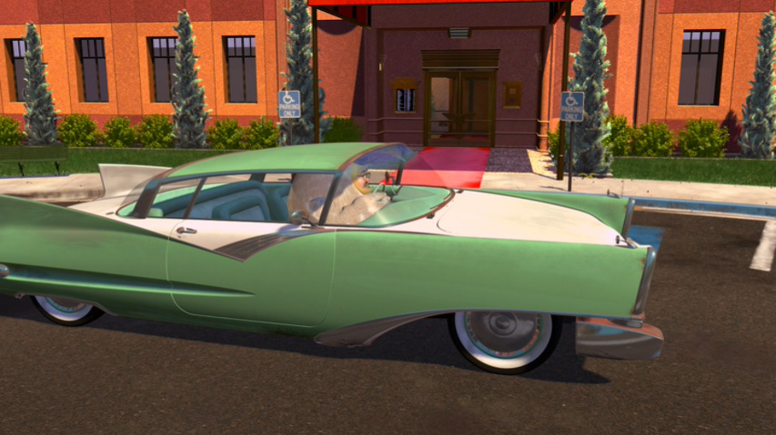

That is the quote that got me originally thinking. The article is from 2009, and Pixar's render farm then could do it in better than realtime. Plus I watched Toy Story 2 and the car scenes (aka ones with a LOT of movement) look to be near the quality of many modern games:
