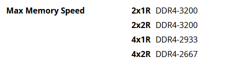

4 sticks at 3200? Is this a quad kit or did you combine RAM kits? I'd try just doing 2 sticks in the appropriate slots and see what happens.
For some Ryzen 5 5xxx series, when you start to increase beyond 2 sticks, the max speed officially supported drops to around 2933.

Yes, that can cause a problem. Different chips don't always play nicely, even if they are "the same". That's why you should start your testing with a single matched pair.
Also, this is for the 5800x3D and the 5700X, so maybe a little different for the 5700x3D, but you can see that with 4 1-rank sticks, the max official support is only DDR4-2933. Throw in 4 unmatched sticks, and you're really starting to roll the dice.
