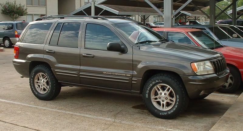

It's a 1999 (WJ). I didn't think the WJ and ZJ would be any different. I didn't do anything to it.. yet. I bought it with the alignment a little off a couple weeks ago... and a host of other problems and services that had to be done.
