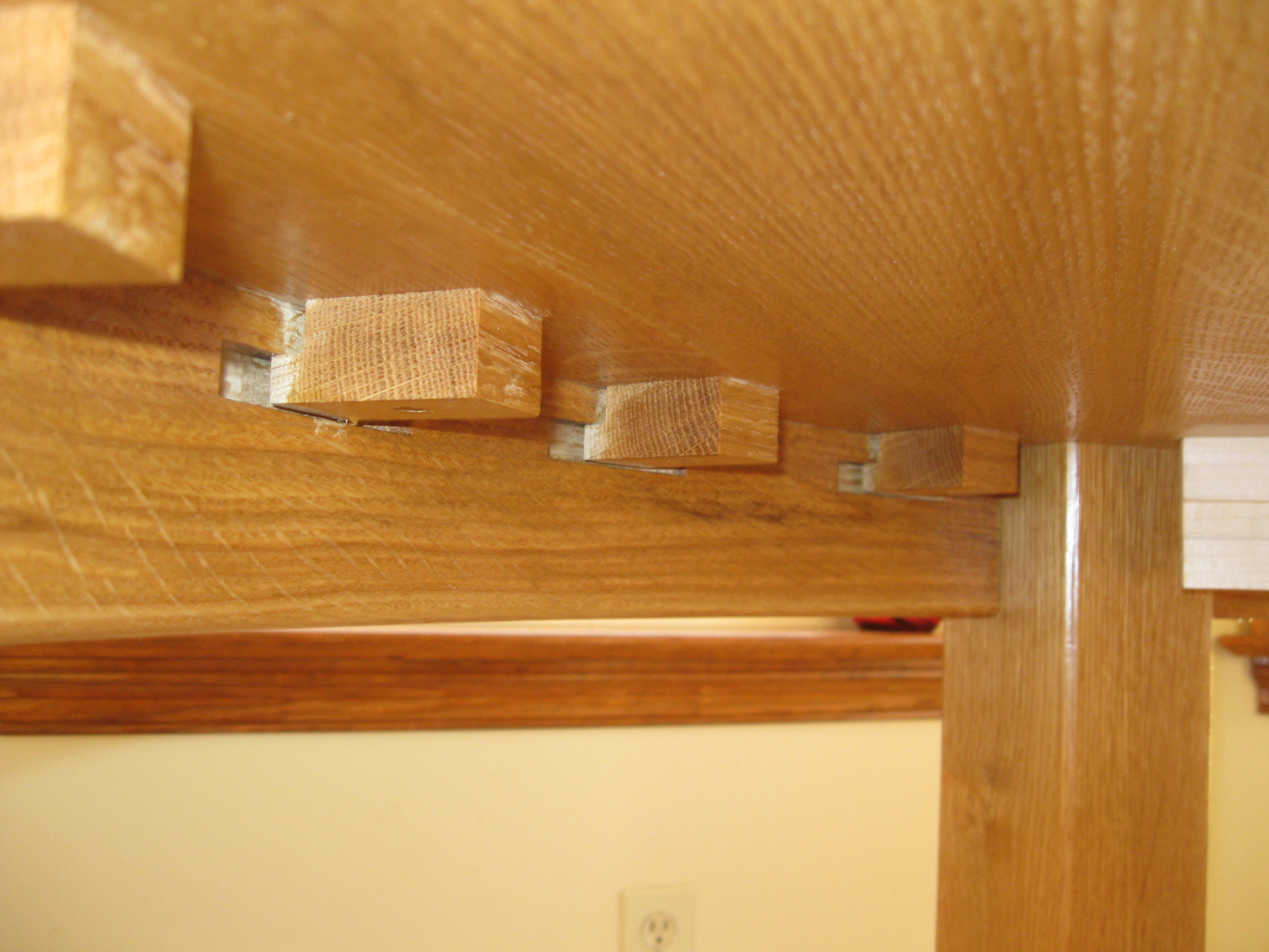

My main concern is attaching the table top to the legs, I am reading that a sliding dovetail is the best way to do this, it will allow the table top to expand, is removeable, and requires no glue, screws, nails, etc. I read also that people use buttons and slotted holes to connect the top, or figure 8s.
Buttons
Figure 8s
Figure 8s seem too cheap for a nice table that is the centerpiece of a room, maybe for a coffee table or side table you don't want to spend an entire weekend on fastening the top to the legs.
Buttons might be okay especially because if I do a farmhouse style table I don't know how a sliding dovetail would end up working.

I've made several farm tables and an "island table" ~44" high, 18" wide, 5' long. Had to fit in the space my sis in law had. Used old reclaimed lumber, heart pine. Hard stuff. Wouldn't go with whiteboard...too soft. I squared the edges on the joiner and gorilla glue/clamped them. Hand planed the tops because that was the look I was going for.
+1 for the breadboard end. Curious about food in the joints and/or if you finish with poly, what's going to happens to the joint when it moves? What about a penetrating sealer and then a nice coat of paste wax? Getting a mortising machine for Christmas. Otherwise I'd use a router/table.
Table+top: Used a skirt board with the "buttons" you've shown. Skirt boards mortised into the legs. Ordered the legs from here.

Breadboard comments. I think the gf wants a painted table, unless the paint is intentionally distressed/antiqued, it will show cracks. I need to ask her what look she was going for. I don't want something that will look bad after a season.
Do you have any experience with sliding dovetail tabletop connections? I think farmhouse table with a buttoned skirt/apron is very common for that type of table. My only reasons for considering for the trestle table is that it would be less wood overall, and the stretcher can be wedged in with no glue, so the top, legs, and stretcher can be disassembled for extremely easy transportation. My worry is doing trestle legs that are too simple might make it look a lot more amateur, whereas it would actually be the norm for a farmhouse.

Not sure how you'd use a sliding dovetail to attach the top to the base on a farm table.
The "buttons" would be easier and work.

The only way I can envision the sliding dovetails working is let's say on the short sides of your table the dovetails are actually standing out above the rest of your skirt. So when you slide your table top onto the dovetails, it becomes flush with the rest of your skirt.
edit: as to the painted comment, yea you are right, and it would require a lot less work on the table top. I basically only have to work on constructing the legs. Would definitely just button the top up then no need for anything fancy like dovetails.
Never heard of it but it should work and be extra work to make. If you want one that will break down, go with the trestle.
a dovetail would be a bad design for a slider.

Sliding dovetail is a type of joint, not something that slides in and out like a keyboard tray or drawer.
Virtually all finely crafted trestle tables will have sliding dovetails for the table top / trestle connection.
