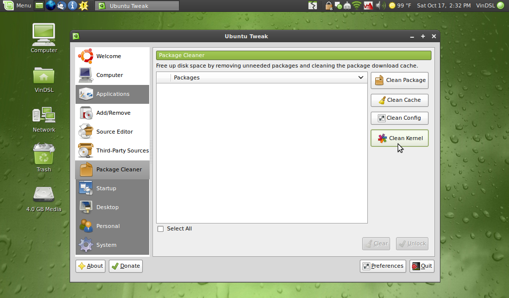

Originally posted by: Ken g6
VinDSL, that's a great piece of software. I was able to use it to turn my windows into jello, but I haven't found a way to get rid of old kernels yet. Do you know of a place where it can?
With Ubuntu-Tweak, it a simple click-click-click away!
Here's a screenie for you...
http://vindsl.com/images/package_cleaner.png (VinDSL.com | Ubuntu-Tweak Package Cleaner Screenie | my Asus Mint 7 netbook)
As, you can see, you can clean up your packages, clear your cache, clean your config, and get rid of old kernels in a few seconds, without ever shelling to CLI.
Simple pimple! 😀
