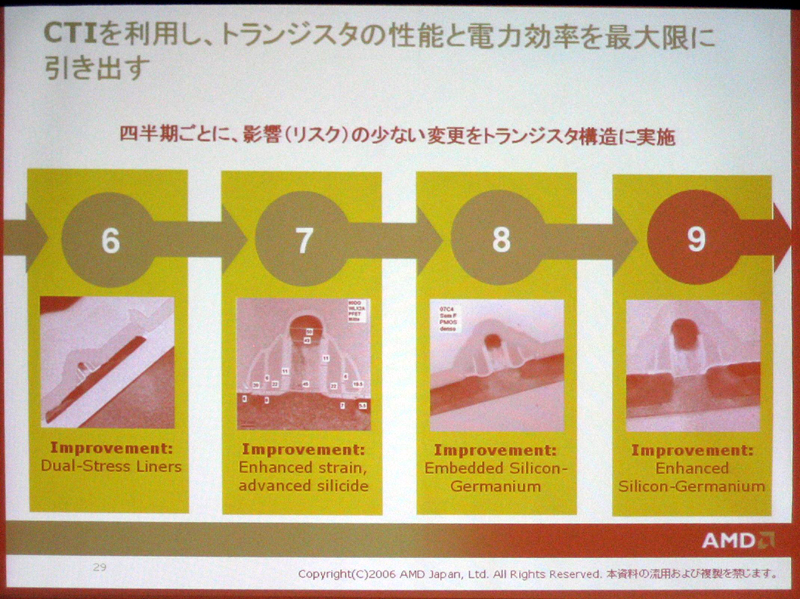

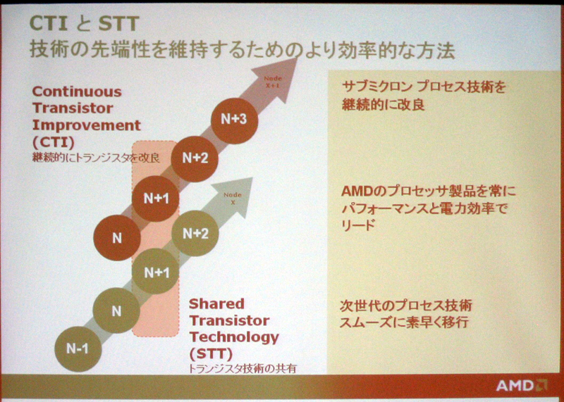

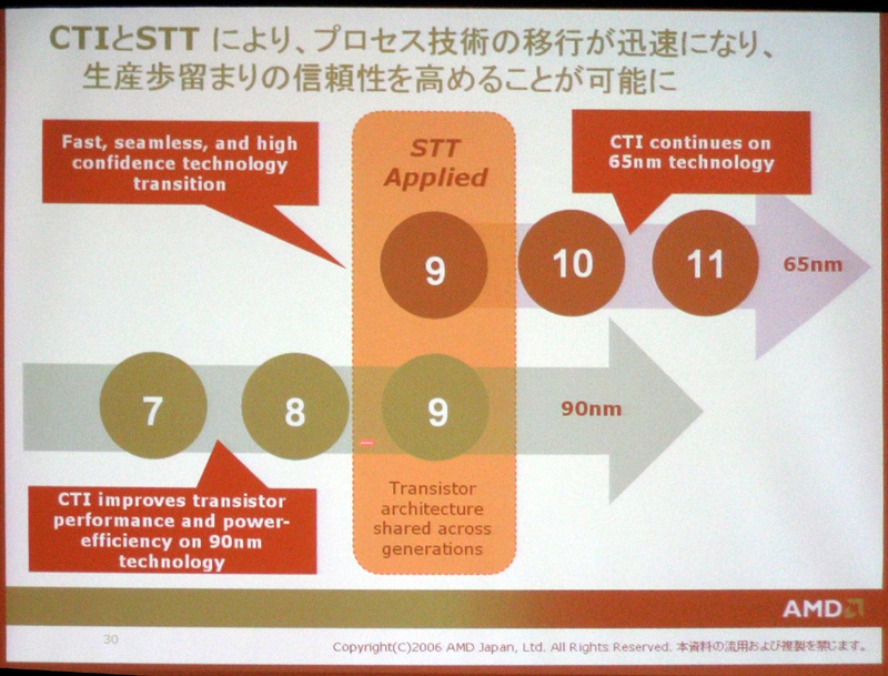

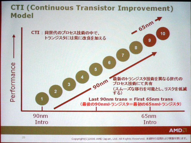

It really is 65nm dejavu all over again. Remember 65nm Athlon X2's had problems just getting to the same clockspeeds of their 90nm siblings, and before Phenom even launched the biggest concern among enthusiasts was that the K10 would not be able to hit the intended clockspeeds because 65nm seemed to be a miss.
If I remember correctly, the 65nm parts were all 65W at launch, while the 90nm parts were 89W+. Did the performance recover if you allowed as much power consumption?
I couldn't remember myself, so I went to the AT article on Brisbane and looked. You are right, the TDP's for the parts were lower for the 65nm chips.
But at least at the time of the initial 65nm reviews the power-savings didn't really show up all that much.
amd&
Your point still stands, the 65nm parts were lower power consumption, but the TDP paints a story that is rosier than the reality.
But the question is of merit, had Brisbane been clocked accordingly such that it ran 10-15W higher in power usage (enough to match Windsor's power consumption) then it would have certainly clocked higher. How much higher though? 200, maybe 300 MHz tops?
There were good reasons why the 65nm chips weren't a major step improvement over the 90nm ones though. AMD had already pulled in many of the 65nm xtor improvements into 90nm in advance as part of their STT (Shared Transistor Technology) program, itself a subset of the CTI Model.
Source
And so I think you are right in asserting that bulldozer's clocks, while falling slightly short of what was needed, are a testament to the capability of the microarchitecture in light of the canary in the coal-mine observation that Llano is in regards to the capability of GloFo's 32nm process tech.
I mentioned "heat density" because I feel we as computer enthusiasts have been spoiled by the benefits of the node progressions.
Every time a chip is built on a new process tech we have yet another reason to rejoice. Faster clocks, Higher IPC, greater single threaded performance, lowered prices.....What is not to like about this?
But when does the gravy train come to an end without making drastic alterations in design philosophy either at the level of process tech or the uarch itself?
If we look at the last three nodes it has been nothing but victory for Intel using planar xtors.
