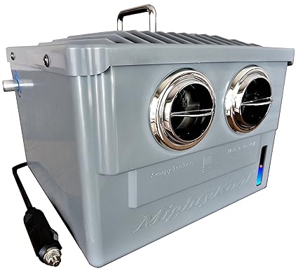

So I have a small, personal swamp cooler (the kind used by truckers inside their cabin):
It's aimed at my head when I sleep. I've heard that the humidity that swamp coolers put out is bad for electronics (corrosion IIRC). So I was wondering if getting a dehumidifier could take care of that problem.
