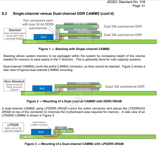

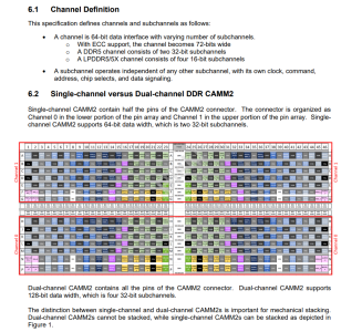

Intereting new part:
Connector between LPDDR and DDR version is the same, but pinout and mounting holes are different.
There's 2-channel version and 1-channel version. 1-channel CAMMs expected to be used where high memory capacity per channel is required.

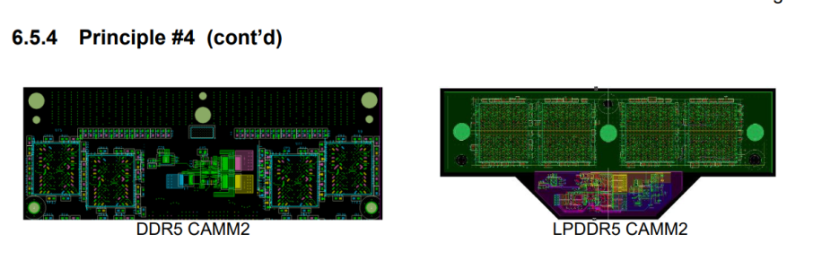

Trace lengths get weirder. With DIMM, each trace from the cpu traveled the same length, but in this format, there's some adjustments for each pin.
Would be cool If this can actually lead to higher mem speed

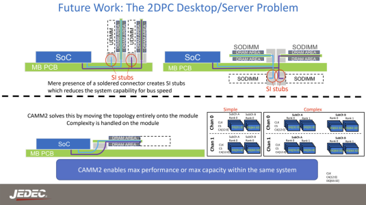

Here's some diagrams from jedec pdf

That is the whole point of designing new memory standard/form factor.
Current DDR memory will be a problem when DDR memory goes really fast. CAMM modules were designed by Dell to solve the issue of signal integrity at those speeds.

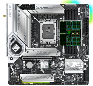

Some people talked about how camm (not lpcamm) is going to replace dimms. Looking at specs, here's how much space camm modules should take up, relative to the mATX motherboard. Spec says 2 compression attached memory modules stacked on top of each other is the max number for dual-channel ddr5 (instead of 4 when using traditional dimms). Each camm has chips on the front and the back, and assuming that one camm can hold 2x the chips of one dimm, we get 16 chips per side.

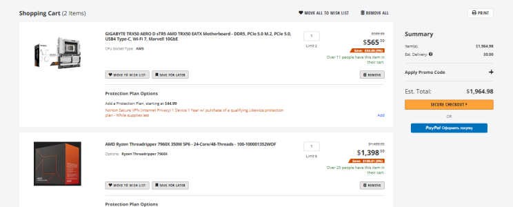

Question:
Since CAMM2 supposedly has dual system memory channels supported within 1 module/socket, could that mean that (with DDR6 possibly seeing it become mainstream on desktop DIY motherboards... if they "fix" the cost) we can see a 256bit/quad channel desktop system like a hypothetical mainstream AM6/Zen7 system?
I already think HEDT/WS/Server will go crazy with channels at that point. Think 32 channel 2P boards/racks or more.
Nah, we won't see workstation-level memory bandwidth on regular AM6 or whatever it's gonna be called, the main limit is the socket design and PCB complexity, not the form factor. Besides, we already have threadripper with Quad-channel mnemory and this motherboard+cpu costs just under 2000 dollars 1720505476441.png

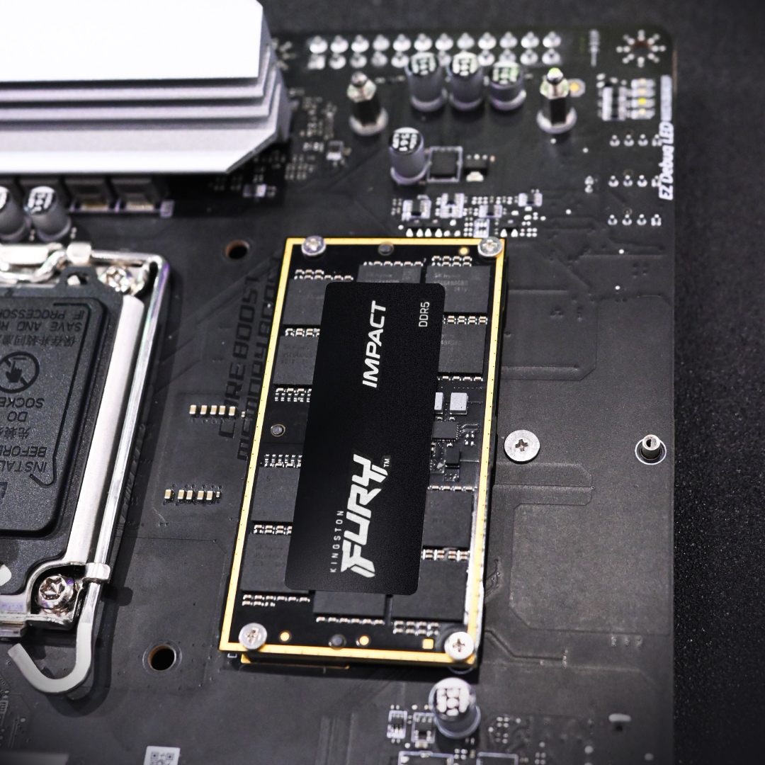

MSI pushes CAMM2 a little...
RnR_au
Jun 6, 2021
2,901
6,490
That's odd. I thought for identical memory types, CAMM2 was supposed to be clearly superior.
From my understanding CAMM2 can have lower latencies, but in this case MSI kept the latencies exactly the same as to the DIMM ram it was tested again.
I think the MSI presser above was just an educational fluff piece, but there isn't much CAMM2 news out there, so... meh :)
