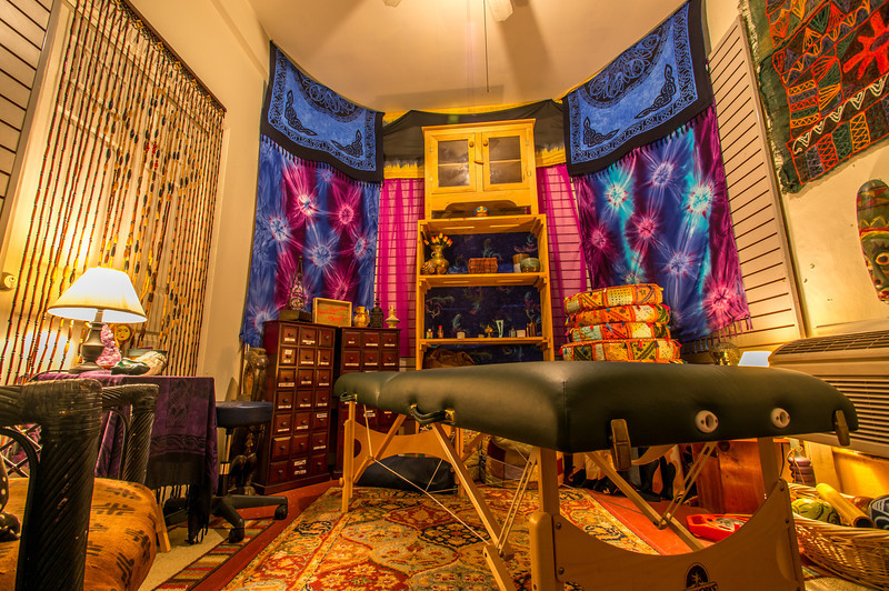

FWIW, I shot the below picture with an SLT-A37 and Tamron 10-24 at 10mm (the owner wanted all the lights cranked up, so not as "moody" as it could have been). You can see how much fits in the frame and (because of the massage table) you can get a sense of how tight the quarters were as well as an idea of the distortion. KEH has the 10-24 in various mounts between $300 and $400. In retrospect, I should have saved some money and gone with a slower lens.
What slower lens is there that goes to 10mm?
The only lens I know of that might fit is the sigma 10-20 f4-5.6, though the tamron and sigma are usually similarly priced. When I purchased my tamron 10-24, I would've probably gone with the sigma if it was cheaper.
A lot of tamron 10-24s have edge/corner sharpness issues.
