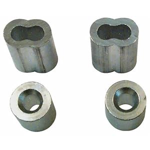

I bought a throttle cable (matching part #'s) for my weed trimmer, but it's slightly too long. I was thinking about cutting off the L-shaped section on the end that attaches to the carb linkage, and of course I'd have to attach something to keep it from coming through the hole. What can I use?

Crimp on electrical connector of some sort. Just use the barrel part?
Maybe a crimp on small fishing weight?

lowes and home depot have them - like this: http://www.homedepot.com/p/Lehigh-1-8-in-Aluminum-Ferrule-and-Stop-Set-7332S-24/100264416
anywhere they sell steel cable

What is the smaller piece for?
I originally thought these were small and cylinder shaped and could be crimped, but I see now that they're oblong shape, like this, meant to hold both sections of a looped cable. But I can't find anything showing what the small cylinder is for.
Might just try a crimped electrical connector (as mentioned) first. 🙂
The single swage is called a 'stop' and is used to keep the cable from fraying and to engage other mechanisms like what you're trying to do.
The double swage is for splicing two cables together or one cable into a loop.
