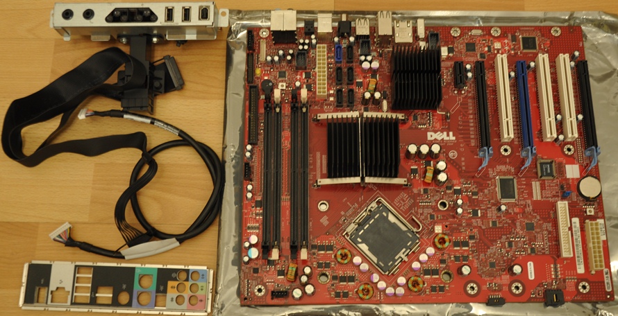

It's either your Video card or your motherboard.
It would help if you had a cheap video card laying around to test and see if that was it. I will say the Dell motherboards used in the XPS 700 series don't have a long life span (5-6 years) I have a couple dead ones sitting in a closet somewhere. I have read many stories when I was converting my XPS to ATX.
One other thought is you could try moving your 8800 GTX to the other PCI-E slot, it may be worth a try?
If it's your motherboard that's dead, you have three options IMO.
Buy a stock replacement motherboard for $$$
Build a new system complete
Replace motherboard with a cheap or used socket 775 MB and mod the Dell XPS case
If you were ever interested in doing the conversion John T. and myself have two threads showing how it's done.
http://forums.anandtech.com/showthread.php?t=2240071
http://forums.anandtech.com/showthread.php?t=2293137

I took it to a local computer tech and it turns out it is the motherboard. The tech is telling me that you can only by OEM Dell motherboards from Dell.. and they're pricey. Is this true? Or is there another place I can get the OEM mobo, or should I buy an aftermarket mobo? He was saying something about Dell modifies all of their mobos so the power cord fits properly or somethin like that.. Idk..
gijeff85
Jun 7, 2013
32
Any suggestions? Should I just go w/ a stock OEM replacement, or can I buy another mobo that would be better?

Hmm my vote be for aftermarket. Although I am not sure if the PSU connector is proprietary, might want to check that. Also for Gfx card. I would look at a 7850 if you can swing it.

You don't have any other options but the stock replacement. I know these PC's very well, and unless you plan on converting your case and PSU to accept ATX, then you may want to start looking for another PC. The price you will pay for a stock replacement is not worth the cost, as most are $300 or more.
They are. They use a 24pin and a 20pin connector. I had to rewire the 20 pin to an 8 pin EPS and added some 6 and 8 pin PEG connectors while I was at it. Converting this case and PSU to accept ATX was a lot of work... but worth it for me because I love the case.

Hey I bet you can salvage lots of parts, like the power supply, the hard drive, the memory, etc., and use those on a replacement motherboard. I mean, you are forced to get a new motherboard, so it's not a loss really.
Don't feel bad about sacrificing the Dell case, because you can walk into a Microcenter store and walk out with a new case for under $20 (though you may want to get a fancier one for more money).
Then just swap everything into the new case and motherboard. So maybe you can get away with spending less than the cost of a replacement dell motherboard. Sometimes there are combo deals where you can get a motherboard and CPU combo very cheap.

KingFatty is right if you want to save some money.
You will need.
Socket 775 motherboard ( I would grab a P35 or P45 chipset)
ATX Power Supply
ATX Case
Heatsink and fan for you CPU
If you buy used, you can save a lot of money.

If he has enough funds and want to spend them, imho it would be better to sell working parts : like memory, CPU, PSU on ebay, craigslist or whatever people use nowadays to sell used stuff and use that money to buy new platform instead.
Even few hundread dollars worth PC based on new platform will be leagues ahead in performance than his current one and he can shave some bucks off a cost by selling his old parts.

Also a good point :thumbsup: All in all it's not worth buying a replacement motherboard for $300+ for an older platform.
