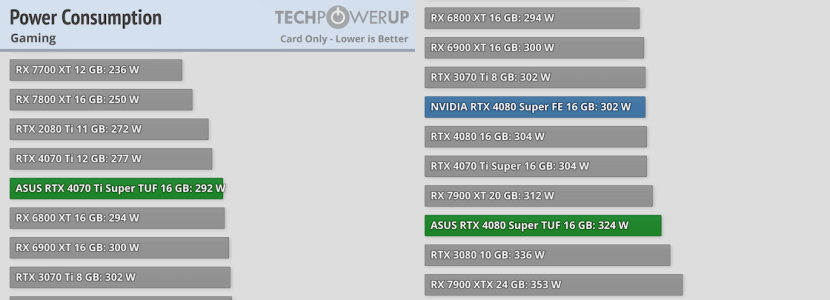

When power is a concern and cost is not, one can always go with the silicon that has more execution resources and downclock to maximize efficiency. Both GPUs use the same die, one has more SMs enabled. The one with more SMs is going to use less power at iso performance (assuming similar die quality). The only catch is the default configuration, but even the 4070TI-S would need custom settings to run @ 230W.
TDP:
4070Ti-S 285W
4080-S 320W

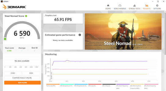

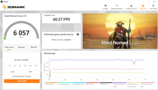

For some objective numbers I ran the 3Dmark Steel Nomad benchmark on my MSI 4080 Super (Ventus OC model). It's on a 7800X3D CPU.
Stock TDP/settings:
72% Power Limit (320 x 0.72 = 230.4W):
At least in this particular (very short) benchmark it attains ~91.9% of the FPS at 72% of the power limit. Not bad. Not bad at all.
