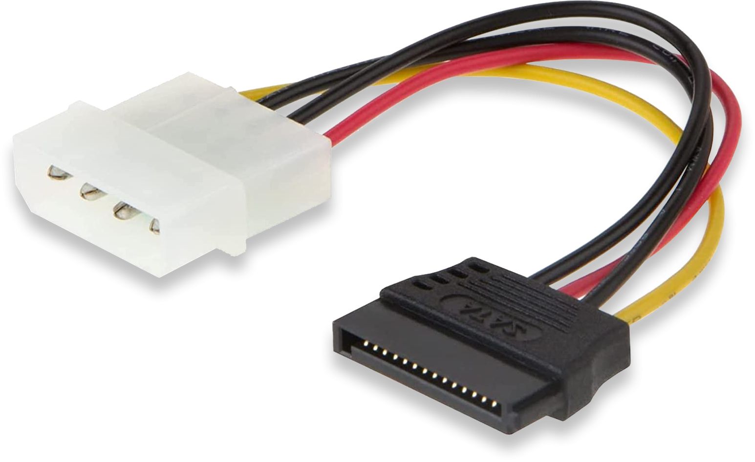

At least you did not manage to reverse the connector. Otherwise, it would be a paper weight.
I did this by accident using one of those hydras that can connect IDE or SATA to a USB connection. Managed to get the big old power plug adapter in backwards.

That's the friggen culprit. Manage to get the molex connector backwards somehow.
