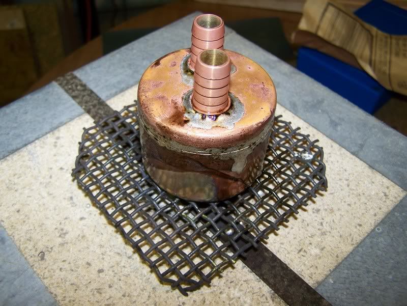

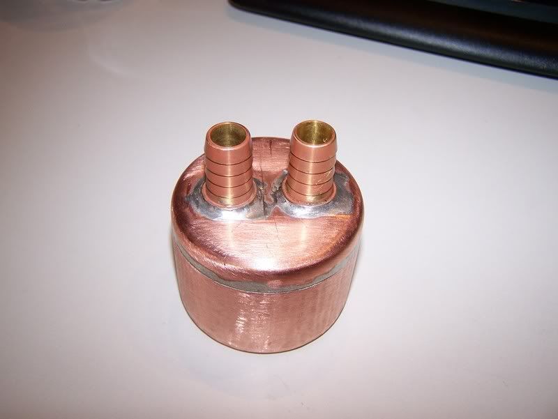

So i just soldered all the parts together, and ill get pictures up later.

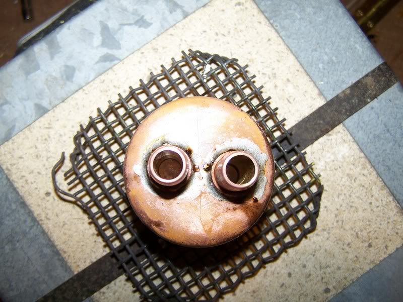

Basically, I took a copper end cap for a pipe and lapped the bottom. Then with another exact part, I cut the majority of the copper off so that I was left with a circular copper disc. This disc then had two wholes drilled into it, inwhich the tube nipples were inserted. Then the disc was attached to the lapped copper, and a complete part was made.

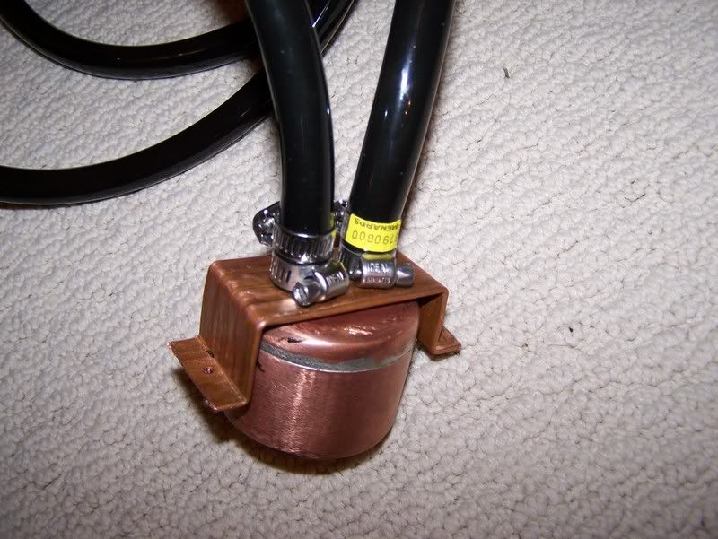

Only thing left for the block is to make a mounting bracket for socket 775. I plan on making it out of Lexan, because i have a large supply of that from another project. It wont lose its spring, so there will be constant even pressure on the cpu itself.
EDIT: made it out of a copper tube that I crushed into a bar w/ a vise*

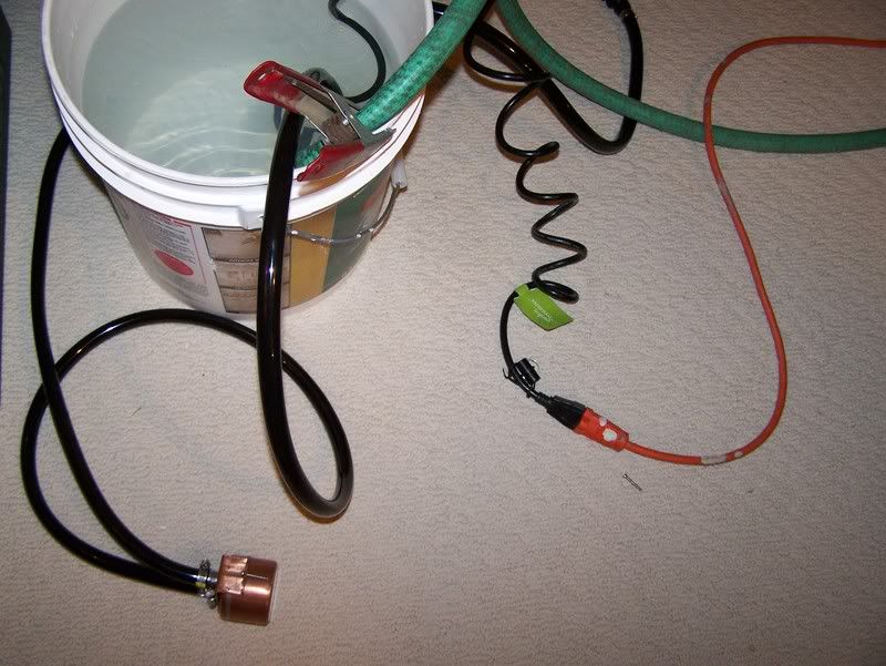

*old idea*For a radiator, I have been thinking of creative things to do. One of my best ideas (imo) is to take a garden hose and lay it in perimeter of my basement. (average temp of the concrete is 60F) Because the diameter is upwards of an inch, flow and friction for the water shouldnt be an issue at all. And, with 30ft of contact with the concrete, im sure ill dissipate a large amount of heat. If the hose cant dissipate that much heat, then I will use copper pipe (expensive!)
I'll do some testing later with some fish pond pumps.(I plan on using this for the actual thing, is this going to be a problem?)

Right after soldering
http://i134.photobucket.com/al...moth_6600/100_0831.jpg
http://i134.photobucket.com/al...moth_6600/100_0832.jpg
After doing some quick sanding
http://i134.photobucket.com/al...moth_6600/100_0833.jpg
I bought a new pump that does 150gph and have been thinking of some new radiator ideas, because the garden hose isnt dissapating much heat....
Thinking a copper bowl/bucket with a flat bottom sitting on the concrete floor w/ a small fan blowing over it?
Leak tested, and it didnt leak! Tomarrow night i will make a mounting braket and maybe get some temps, probably friday though

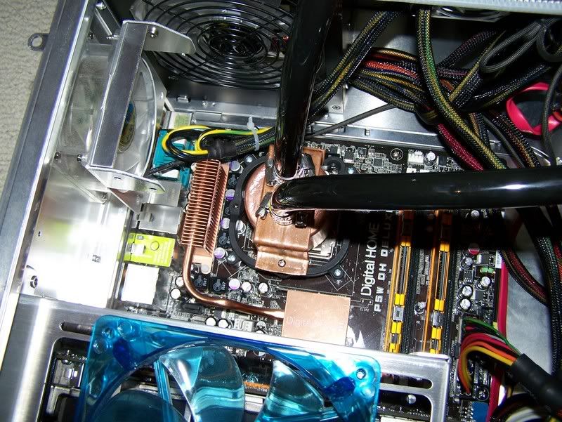

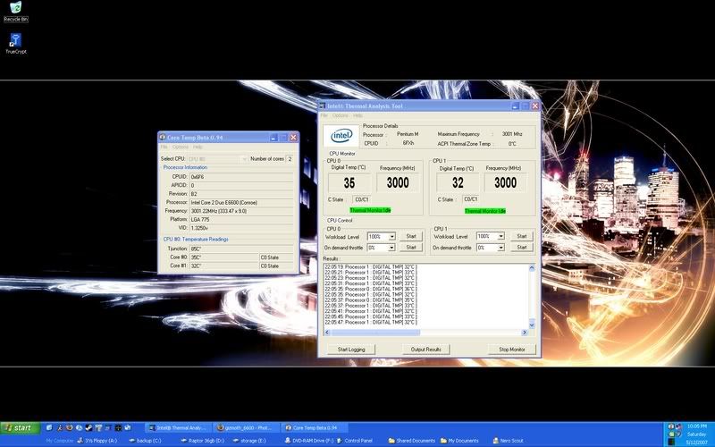

Got the bracket done, and have a temperary radiator. Hooked it all up, and my idel temps are at 33C
I'll get some pics up soon
EDIT: Pics up
bracket and tubing: http://i134.photobucket.com/al...moth_6600/100_0836.jpg
leak test: http://i134.photobucket.com/al...moth_6600/100_0837.jpg
All set up: http://i134.photobucket.com/al...moth_6600/100_0838.jpg
temps: http://i134.photobucket.com/al...moth_6600/untitled.jpg

Originally posted by: trOverBasically, I took a copper end cap for a pipe and lapped the bottom. Then with another exact part, I cut the majority of the copper off so that I was left with a circular copper disc. This disc then had two wholes drilled into it, inwhich the tube nipples were inserted. Then the disc was attached to the lapped copper, and a complete part was made!
Could you post a sketch of what you actually did?

My radiator for now is just a 5 gallon bucket with a 30ft garden hose running on cold concrete in the basement. I figure it would a LONG time to move the temperature of that water up a degree or two. When i turn off the pc, the water cools back down to room temp, and it starts all over again
Ill try to make one tonight

"I'm not an engineer, but" I would be careful using solder as a seal like that, if the temp changes, it splits open and you get water on the guts, you know...
That wont happen with hard soldering - if done properly.
Havent had a single leak or drip yet. I guess i did it properly!
