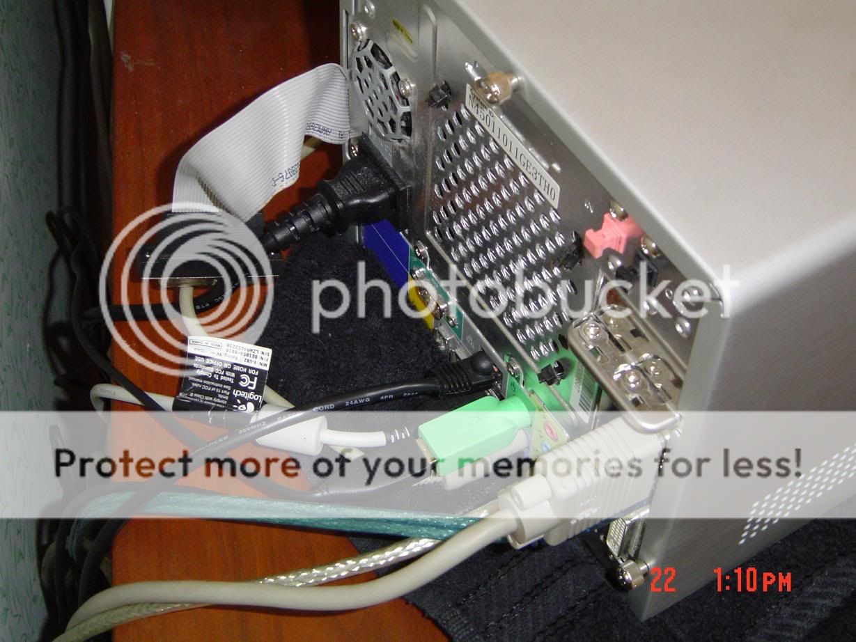

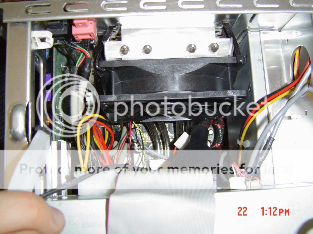

Any normal Shuttle XPC small form factor pc. Get a passive video card and "silentX" shuttle Power supply. Then, cut out the exhaust grill and replace the exhaust fan with that 92mm Panaflo (30dB rating) fan. It works WONDERS and you won't hear it from 6-7 feet away. This way you only have 2 fans in your entire system and it is EXTREMELY quiet, from that distance I'd say "silent." No annoynig hiss/buzz or vibrations.
92mm Fan mod in My shuttle 12nd pic!the 3rd pic wahoo!
