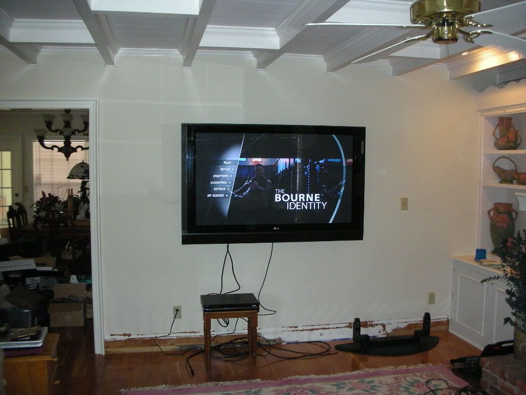

Here's an update on progress so far, with pics too.
The install began on Tuesday. Bringing the TV inside and unpacking it my Uncle commented that looked ah heck than he'd thoughit would be. "I looked at 60" TVs at Sam's and they didn't seem that big. This thing is huge." I just smiled.
Cut-in a box behind the TV with a recessed electrical outlet and an outlet for the HDMI cable too. A flat-panel wall mount with a 200 lb+ capacity was added and the TV was put on the wall. Connected the HD-DVD and put on Bourne Identitty. The LG displays a really nice picture from an HD-DHD player.
http://i216.photobucket.com/al...Chicken_bucket/ht1.jpg

No dount some people may be wondering a few things, such as why the center channel was positioned verticaly instead of horizontally. (We even had to make a frame for it.) There was one rmajor restriction Between the right edge of the center channel and the left-edge subwoofer there used to be a door. My Uncle closed it up, but now there's just paneling covering the front side, and the opposite side is a shelving unit. I could not build into that area. :( Had to work around it.

They are actually still far enough behind. They are located in the ceiling of a bay window. I was worried that their sound might get lost but a little tweaking of the Onkyo level calibration allowed for them to create a nice little spacial image. I was surprised how well those speakers sound, tbh. I didn't hold out much hope for them but they can really crank. Of course, ideally you'd want these speakers on the side instead, but the layout of their living area didn't allow for that configuration.
I can't wait to get the sub amp installed and get some serious thump going since the low end is prety subdued right now. It's really going to freak them out when they hear the sub kicking.

That's a fine finish job on the HT, mang. :thumbsup:
