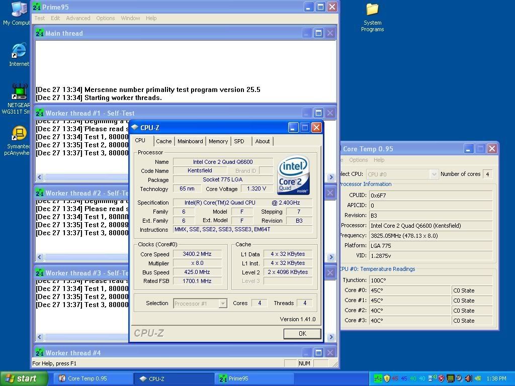

Lastly, here i go with my proofs again:
The voltage set in bios is 1.4V @ 3 min load here is the voltage according to cpu-z http://i125.photobucket.com/al...73/aigomorla/CM690.jpg
Thats 1.320 .... after 30 min here is the voltage again:
http://i125.photobucket.com/al...p73/aigomorla/Temp.jpg
It raised to 1.336V
The BOARD is not stable with voltages. My P5K wont vdroop a second time like this IP35-E will. The IP35-E is a great board if your doing little to no overclocking. But long term ocing and heavy ocing the board is no to go.
If you dont believe me PM PCTC2. Thanks to him i didnt lose too much sleep when i was pissed i couldnt get this system stable.
PS. that Q6600 can do 3.6ghz @ 1.47V only problem is the BOARD wont do it. And i have more then enough cooling for this type of overclock. But as i said, THE BOARD WONT DO IT.

Same chip different board showing you guys that ITS THE F'n BOARD on why i cant get 3.6
http://i125.photobucket.com/al...73/aigomorla/Q6600.jpg
Bios voltage on 680i was set @ 1.55 which translates to 1.48Vcore loaded. First time a P35 board lost to my crappy 680i.
