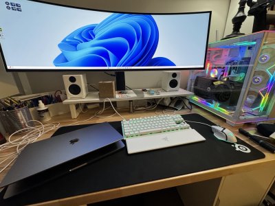

As an aside - ill take some better pictures after i figure out all the lighting and positioning and share some of the 'in progress' pics later but, she turned out okay despite all the headaches!
