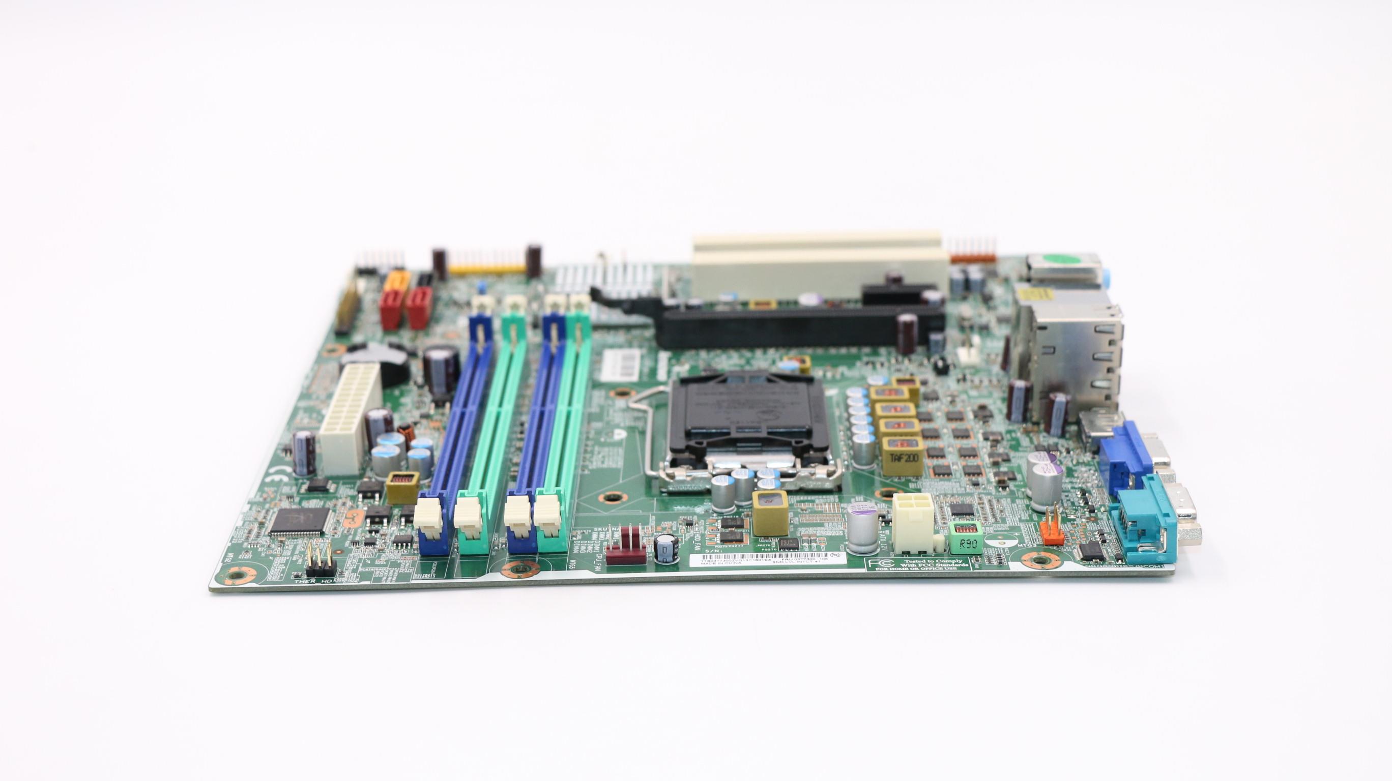

If you haven't solved it yet, is this the board?
Looks like just a push over plastic spring tab. If you remove the CPU cooler you could push it with a pen or something.
Make sure you have removed the screws from the slot bracket of the GPU, as well as any display cables from the back.

I posted clear pictures. If this is your MOBO then it's very obvious how to release the clip even if partially broken.
As I said, from the CPU side just slide a small poking stick under the GPU at the end of the slot to push the lock over.
Or remove the lower heatsink (metal spring clips) and use a bent paperclip or whatever to grab and pull the broken tab.
This is a picture of a GPU as it slots into the MOBO, you can see the hook on the back (opposite the metal bracket).
You don't want to push against the hook of the card, but on the plastic clip that is holding this portion down.
