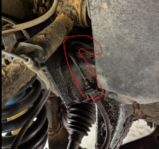

07 Tundra, brakes were acting squishy this afternoon when I went for a quick store run, by the time I got home I almost had to e-brake my way into the garage. Get out, I can smell the fluid and there's stuff sprayed all over the inside of the wheel well and dripping out of the garage like a murder victim.
After letting things cool down a bit, I found a rather large hole in one of the hard lines, looks like salt's just disintegrated it. So, a few questions:
I can't find this specific 'line' on diagrams/online, are they just 'standard' length hoses? This one's about 12" long. Can I buy one and just gently bend it into shape/use a pully/round object to bend into shape?
Is this realistically serviceable without removing the wheel?
Is the brake fluid going to just dissolve everything under the wheel well? My understanding is it's pretty caustic.
Is this worth me trying to do, followed by a car shop inspecting everything? Or are they just going to turn around and say 'yeah that one looks great but the other 25 hoses are just as dissolved, we gotta do the rest now' and it end up costing me the same amount anyhow?

Replacement successful. It was so rusted through that the nut was welded to the flange, and the whole mess just twisted off of the line itself. After some cleanup, I got the new line on, though I can't guarantee it's the same nut flaring, gonna have the shop check it to make sure it's okay (it doesn't match OEM). No leaks though!
Rear brakes' bleed bolts are rusted solid too, and wd40 didn't help, so guessing it needs some lovin' at the shop as well. I can get there with 30% or whatever brake power so they can deal with this at that point :p

Took it in to the shop, they confirmed the new line looked great and the other line definitely needed replacing as well. They also exclaimed that the rear bleed valves were indeed a pain to get off lol.
All good now though! On to the Camaro repairs!
