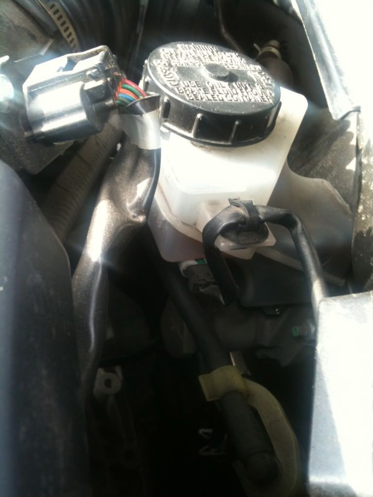

I looked at the reservoir and well... I found that I'm not very good at telling how much fluid is in it 😛. Given how opaque it is, I could see that there is fluid in the bottom portion of the reservoir, but up near the MIN and MAX line... I'm not really sure. There didn't appear to be a blue tinge there.
blue tinge? :O Brake fluid is like clear/yellowish. Usually old fluid looks like dark honey. Now your saying Blue? that I have no idea.
Shine some light in, it should help

Odd... I mean, I shined my flashlight on it and the bottom of the reservoir looked somewhat blue through the opaque container.

I took a look at it earlier today, and I took a picture. It's not too easy to get a good shot of the MIN and MAX lines though.
http://i93.photobucket.com/albums/l51/shin_aikouka/IMG_0135.jpg
Photobucket seems to have shrunk the picture... I can upload the full size if necessary. If you look near the back, you can see what I meant about the blue color, but near the front it seems to be the amber-ish color that thescreensavers was talking about.
