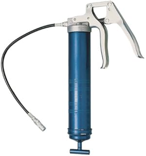

-- Lube. Easy to forget with today's sealed-for-life world.
