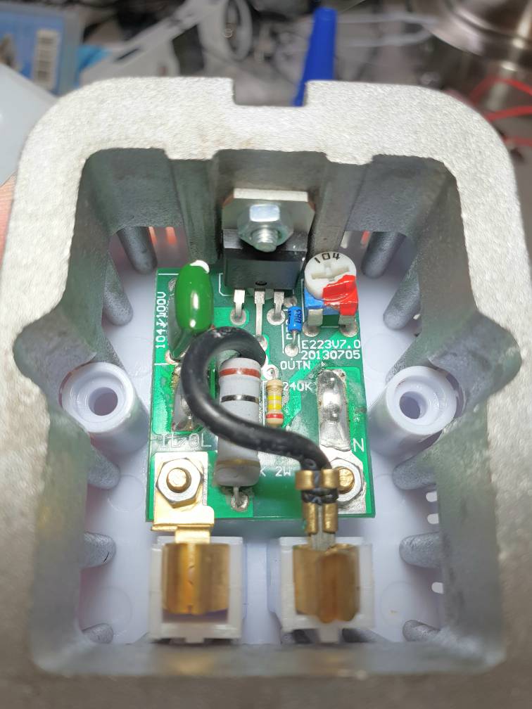

I have a gift for a friend in Australia and the item draws 40W @ 110V AC. It's meant to be always on (small little hydroponic grow kit with LED lights and water pump and touchscreen).
I bought a "50 - 1875 Watt" step down converter and opened it up. My device only uses 40W max so is this going to be a problem?
All it uses is a MOSFET to step down the voltage and a large heatsink that it's attached to. There's an adjustment dial to fine tune the output voltage.
I'm under the impression that MOSFETs generate a lot of heat. Will this unit fry itself if left on to draw 40W basically 365/7/24?

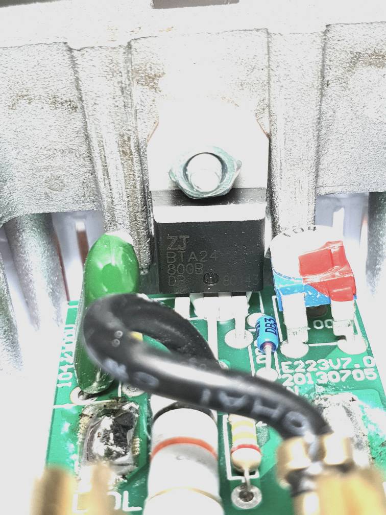

That's a TRIAC not a MOSFET.
It's sinked reasonably well.
However you probably want more than 40W on it.
Those converters are fine.
Until a spike hits them. ;)

oh wow that's awful.
that's a standard triac-diac dimmer circuit being used as a 'step down converter'??? it's even got a little trimmer lol. i'm assuming they have it set to fire at ~120 on the 220v cycle.
i'd imagine how this thing behaves is completely dependent on the load. resistive - fine. inductive - hell naw. smps... i dunno. the rectified waveform will be missing a lot and the input caps won't be fully charging . are there any youtube reviews under load?
the best option would be a legit step down transformer

I'd be curious to stick a scope on the end of that. I doubt it's a pure sine wave coming out the other end. Does look like it's a triac, rated for 25A, so technically will be fine for a 15a socket. https://www.st.com/resource/en/datasheet/t25.pdf
I don't think it would do well with any kind of motorized load though, but probably be fine for resistive loads and SMPS based loads like computers. I'd stick a scope on it though to see what the peak voltage is.
