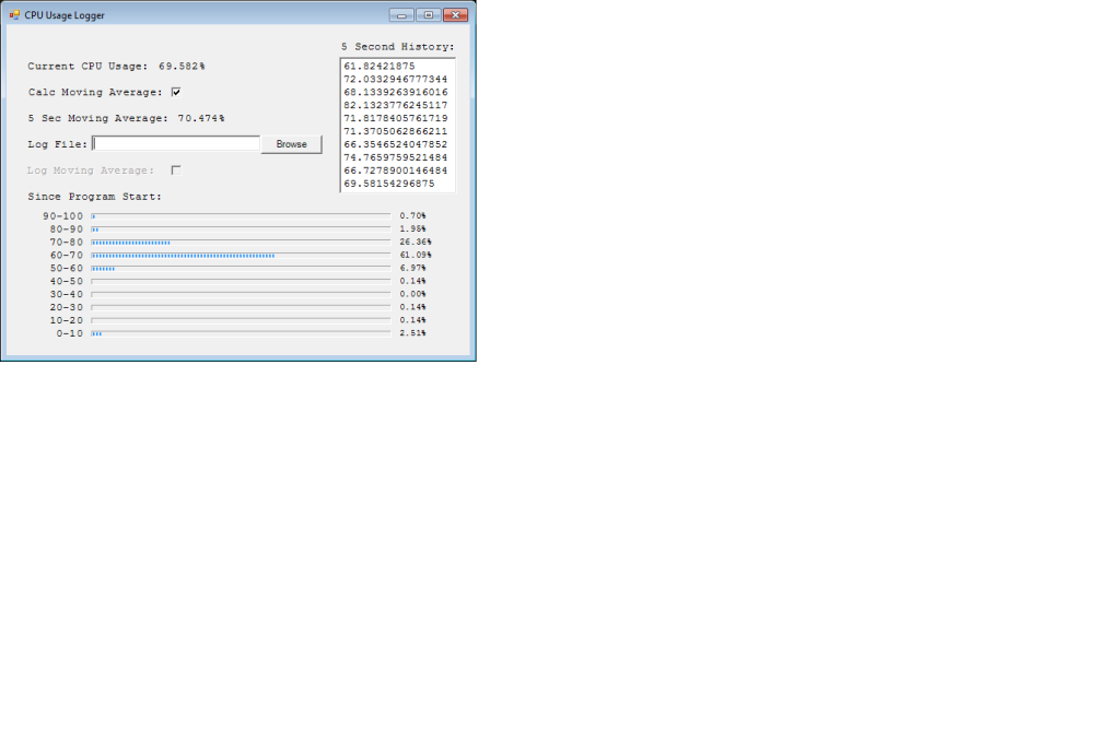

Kharg Island 32 player map CPU usage. 2500k @ 4.4ghz

I didn't graph mine, but did just play a bunch with vsync off. I averaged roughly 85-90% CPU. I am certainly CPU bound. GPU was around 80-85% average. It would hit 95-100% in certain areas. This was on 64 player Caspian Border. Which IMHO is a worst case scenario as far as BF3 maps go.

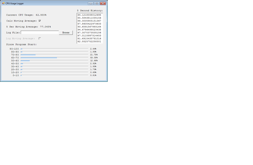

4Ghz 2500K on Operation Firestorm 64 players map. Almost fully loaded on CPU all of time, no wonder my crossfire scaling is not fully utilized because BF3 itself needs much more CPU power on 64 players map.
Noticed you are using the same program I found :) I think I might make a program tonight that monitors and logs CPU usage more precise. I would like to see my exact numbers on all 4 cores. I want to see if this actually hits 100% at some point. I am betting yours is for sure but how many cores is hitting 100% is the question.

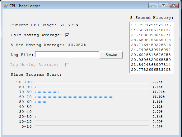

FX6100 @ 4ghz 64 player map Gulf of Omen (all 6 cores)
FX6100 with 4 cores enabled (Grand Bazaar 64 player)
6 cores enabled (Grand Bazaar 64 player)

This just about proves it that 4 cores choke on BF3. HT would help and I find it interesting that bulldozer didn't even touch 80% on 6 cores. I am kinda upset that this 2500k is bottlenecking in BF3.
