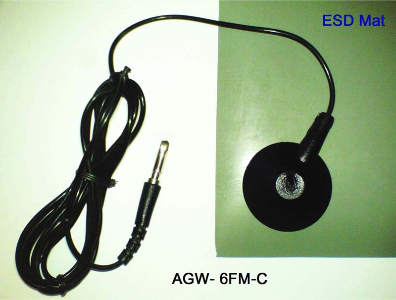

Couldn't you just rig up your own ground cable with a banana plug?
Edit: Something like this:
I think you could use some heavier gauge audio gear and make it work.
EliteRetard
Mar 6, 2006
6,490
1,021
Should be pretty close, banana at 4mm and I think the ground pin is 3/16 (4.76mm).
Edit: Also notice the ground wire prong is a U shape so the round 4mm plug may fit snug without issue...
Just pry a little on each of the bulging sides to spread the plug out if you need to.

Got my solution! Going to get an alligator clip wire to banana plug! Will use the alligator clip to attach to the wall mount and the banana plug end to stick into the wall socket. This will work perfectly and take less than 30 seconds to install! Thanks everyone for your help!

Worked perfectly!
I had 5 TVs to do this to and ordered this: http://www.amazon.com/gp/product/B00...?ie=UTF8&amp;psc=1
I mashed down on the banana plug so it was wide enough to seat into the ground outlet. The plugs were right behind the TV so 12" was perfect. I attached the alligator clip to the bolt that fastens the mount to the TV. Buzzing 100% gone! Took < 30 seconds per TV!
