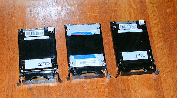

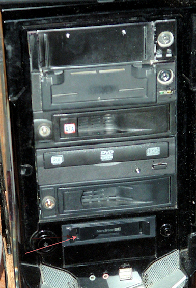

Not advocating my solution - it is different. I prefer independent drives fully installed with the same software, each easily selectable by using EZ-Swap 4 trayless racks. This gives me full independence of each OS without multi-boot. This illustrates:
Same Idea as corkyg's (Not visualy so nice :hmm: ).
The top are mobile trays with 1TB HDs used for Data Storage/Backups (can be used as boot too if needed, and other purposes as well).
The key is the 2.5" tray at the bottom (red arrow pointing).
It take 10 sec. to switch in and out these trays.
I keep a collection of them, all with SSD drives (can be used with regular Laptop's drives as well).
The two OCZs are 64GB, one with win 7 and the other with Win 8.1 (XP SP3 runs Virtual on the Win7).
The center tray is Talent 32GB with Mountain Lion (the computer is capable to be configured for OSX).
Can Not be more flexible and stable than such arrangement.
Vantec Mobil Rack - http://www.newegg.com/Product/Produc...82E16817986002
Extra trays - http://www.newegg.com/Product/Produc...82E16817986004
