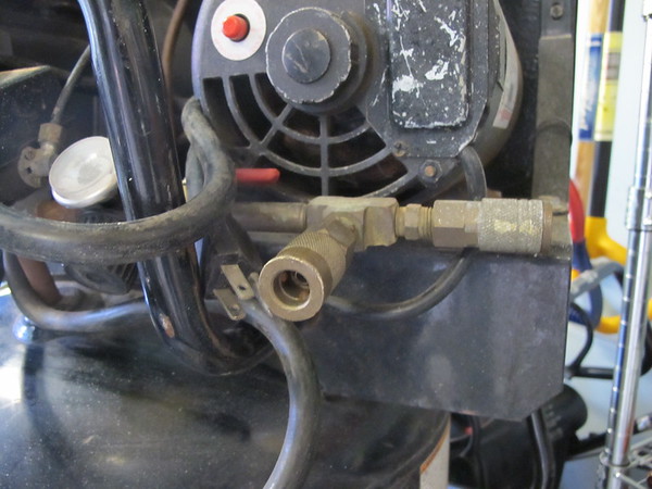

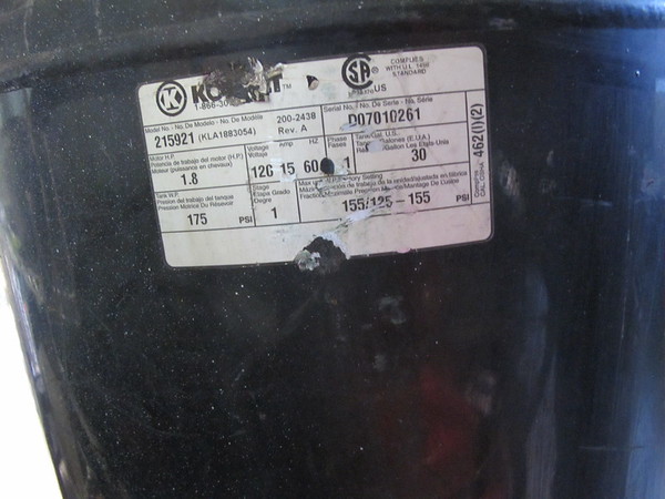

edit: got a 7 year old Kobalt 30 Gallon compressor off craigslist for $200.. should be more than enough for anything i'll ever need in the house!
