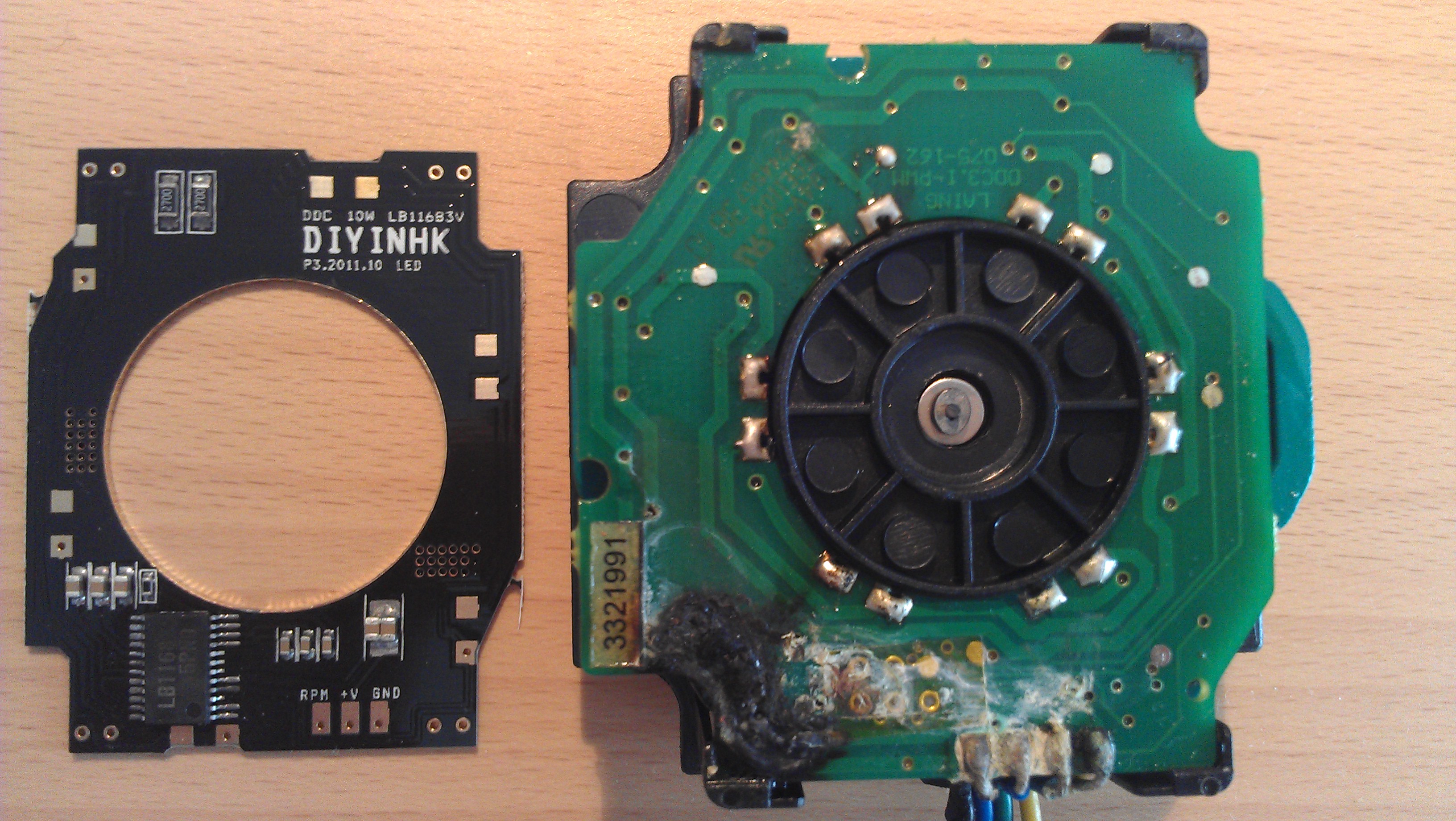

Now you telling me to go with two loops or to buy another pump (will be 3 totally), to protect my $2000+ investment, because of a pump failure. I'm now very confused :\:confused:
yes because is 79.99 NOT WORTH it to protect the 2000 dollars?
and ive had DDC1's fail because they were paired with DDC2s.
what happens is the weaker head pump gets forced to spin higher and faster then what its designed for.
Water isnt compressible... so its like a tug of war... only going in 1 side... as u can tell if 1 person is too strong.. the second guy will get PULLED.
This causes the PCB to get hotter due to more work being displaced by pump.
This causes the DDC's to:
ask your hydro friend how many years he's played and used laing pumps.
I have 13+yrs working with laing in our hobby... (DDC + D5 especially....)
In the 13 yrs i learned u dont miss pair pumps. (the guys at laing even told me... not to mispair pumps..)
(i use 6 pumps... 3 loops... to protect hardware probably close to the value of yours core wise.)

PWM DDC is an exception as the ddc forces max current though the PCB via PWM sense.

The MCP35X Pump is PWM controled. Does it count?
Also could I disconnect one pump (MCP35X which is integrated at the bottom of the Swiftech 240mm Radiator), and just stay with MCP655B Pump for whole loop. Buying option is very difficult for me becouse I'm not from USA, and in Lima/Peru, there's no WC parts in shops, only importation, or to go with two loops (as shown on the sketch in my previous post).
aigomorla
Sep 28, 2005
21,134
3,673
35X is a PWM pump so it doesnt count.
It limits voltage sent to pump.
so if ur ddc is a pwm ddc... then its fine to mismatch.
Your D5 will do all the work.. and your pwm ddc will probably not see much usage unless ur cpu went to load.
And i assume u dont load your cpu 24/7 to make your pwm ddc load up full all the time.
Even then it still limits max voltage sent to pcb @ full.
So if ur DDC is PWM ignore my warning.
And then in your scenario i would single loop with 2 pumps... so basically what u have setup now.

I think the 35x is DDC pump and 655B is D5 pump, right?. If so it's mean I'm OK wit my loop or not.
The pics of my pumps:
MCP35X Integrated into Swiftech Radiator
MCP655B
both pumps have one 4 pin molex connector and apart one 4 pin connector, the only difference is that the 35X have two wires (one green and one blue) from 4pin connector while 655B have only blue wire. Both pump are connected via molex to the PSU and via 4 pin connector to motherboard (35x to 4pin CPU fan connector and 655b to 4 pin aditional CPU fan connector). Does this mean that I'm safe with my loop, the both pump are PWM or not.
Need help and explanation.
Thanks.

yes ur safe.
the green wire on the ddc is the pwm sense line.
make sure that is plugged into your motherboard pwm fan header.
