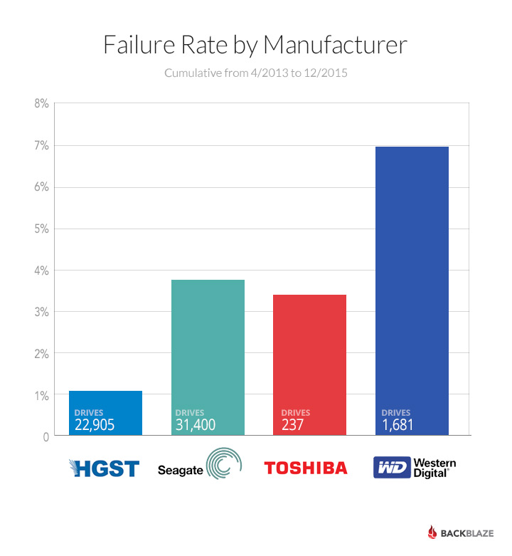

backblaze decided to use non-enterprise drives for their cloud backup
https://www.backblaze.com/blog/hard-drive-reliability-q4-2015/

On a pure reliability standing, HGST is the most recommended these days, followed by seagate, and toshiba & WD heading up the rear.
As was pointed out earlier, if you look at the backblaze data:
Does that mean HGST will never fail, and WD will always fail? Nope.
We are dealing with sample sizes here, but it does give you a rough picture on what is going on.
Frankly, I have had more WD RED issues (multiple drives just went belly up, with no SMART warning at all) than my WD black drives, and it is difficult to recommend WD RED these days, but, again, my sample size is too low to make any hard judgments.
OP, these days it don't seem to matter that much as to which HD you pick, you just need to use backups, and that will do away with the failure issues that all HDs (and SSDs) will eventually have.

Wow, I didn't know the WD Reds (and WD) in general were bad. The last time I looked into HDDs Seagate was the worst with HGST being the top. I was gonna get a WD Black 6TB 128MB cache but after reading how it's the loudest HDD I'm gonna pass as I leave my tower in my bedroom.

I can't really comment on the reliability report that is being released every now and then, but there's quite a lot of discussion if it's legitimate or not and how accurate it is.
