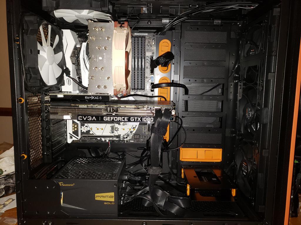

My son damaged his case a Thermaltake Suppressor F-51 (which I never thought was a good case) by damaging the USB and audio headers on the front when he got up and moved his mic and headphones while forgetting they were plugged in.
Now I could have ordered a replacement panel, but what's the fun in that?
This case is very well built, and very quiet (even more so than the Fractal Design R5 it replaced). However, I do not recommend this case for a new builder, as there were a few things that Be Quiet did that had me saying "Really???". A quick summary of pros and cons:

So since my case isn't the "pro" version, it has solid panels, so I didn't spend the usual amount of time making the cabling 100% neat like I would on a windowed case. And I also took pictures of the Dark Base next to the Fractal Design R5 to show how much larger it is. To save people a headache who have slow internet or who are on mobile devices, I created a gallery instead of embedding all the pictures here:
