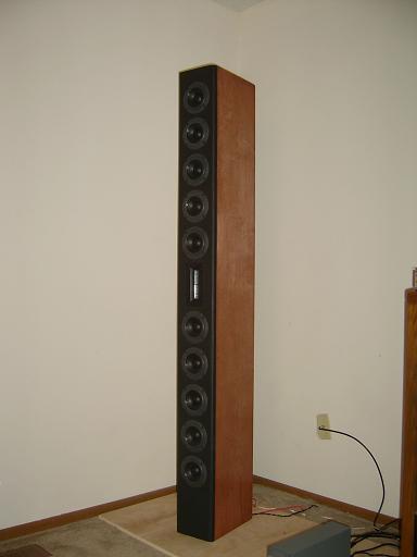

Finally, an intelligent response and I can vouch that everything he said is correct.
Now, I get to pimp out the last pair of speakers I just built. These aren't completed pics as they still need bases. A cheap gift for my brother at just $300/pair for drivers:

Nice Tower btw.

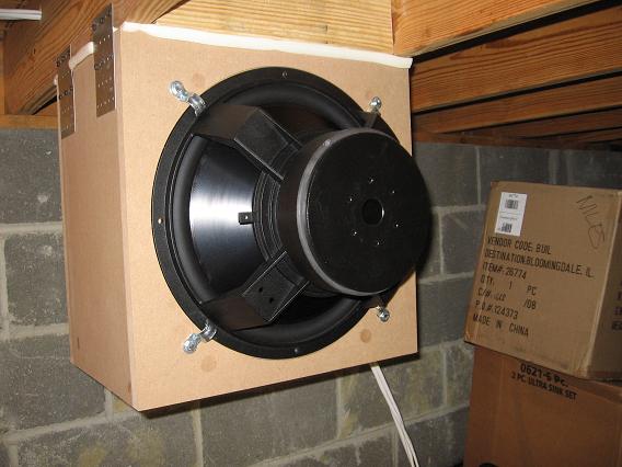

Ummm...I never said there wasn't bass below 40 hz in music. In fact, my 2-channel system has four Dayton RSS390HF 15" subs in an infinite baffle config that is flat down to 10 hz.

Nice Sub setup or is it set down. ;) I had thought about doing a setup like that since it is pretty easy to do as far as design is concerned. I am getting by with 2 12's in stereo format.
