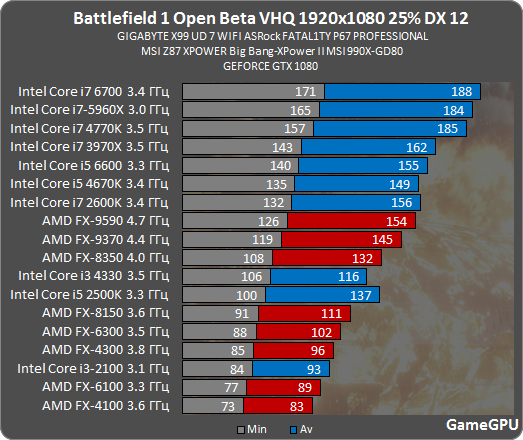

Battlefield 1 Beta CPU scaling performance
Carfax83
Nov 1, 2010
6,841
1,536
This latest iteration of the Frostbite 3 engine seems to be exceptionally optimized CPU wise to get such high frame rates. You don't see any boost from DX12 unless you go to the very bottom of the list with the slowest CPUs. But this DX12 implementation is definitely beta, so I'm sure it will be improved by launch time..
Not sure how much more they can get though, as their DX11.1 path is really good.. Which kind of confirms what I've been saying in the VC&G forums. DX12 is practically useless for games unless those games are bottlenecked by the CPU..
Games like BF1 which are designed for current gen consoles don't have the complexity to really benefit from more powerful APIs like DX12, since the much faster desktop CPUs available in gaming PCs typically overcome the CPU overhead for DX11 with ease.
So BF1's DX12 path is probably only going to benefit those with low end CPUs, and those with ultra high end rigs that use SLI and XFire..
When games for Scorpio and PS4K start being made, then we'll see much greater benefits from DX12.

There's barely any action going on in GameGPU's test sequence though, one of the best case performance scenarios you can have in the game, and I know the test is like that for repeatability purposes. But anyone that has played Battlefield 1 or any other BF game can agree that performance is alot different when there is more action.
ozzy702
Nov 1, 2011
1,148
527
Yep, 64 man servers with a lot of action going on makes a huge difference, I swear it's almost double the CPU load than these canned benches.
This doesn't confirm that in the least.
You're looking at a game which MUST by definition still conform to DX11 design patterns in order to be compatible with DX11 and concluding that DX12 is useless. Did games that ran DX10 and DX11 look anywhere near as good or run anywhere near as well as games that were only DX11? Obviously not.
They have to build to the lowest common denominator among all code paths: DX11, DX12, Xbox One, PS4. The lowest common denominator is DX11.
We will see DX12 with the stops pulled when we see games that are incompatible with DX11 altogether.

The sad thing right now with DX11 vs DX12 in Battlefield 1 is that even with old/slow CPUs, DX12 is only marginally better at best. In BF4 and Hardline, changing from DX11 to Mantle made a tremendous difference for CPU limited systems. In the results above, we see that the FX 4100 gained only five FPS by using DX12.
And considering Dice has been most vocal with the move to low-level APIs and showed great results with Mantle, I'm disappointed that even Dice can't show DX12's superiority right now.

For all the people saying DX12 sucks in this Beta. You realize that when you click on DX12 in BF1, it explicitly states that it is unstable? Obviously the devs will focus on DX11 first.
You seem to have a penchant for taking quotes from posts, without reading the entire post itself. I actually mentioned the console factor in my OP, so you bringing it up again as a counterpoint is redundant, since I already covered it in my OP.
In my OP I stated that we'll see the true benefits of DX12 when the Scorpio console is released next year. It will be much more powerful than current consoles, so developers won't have any excuse to really crank up the image quality and detail.

Really bad showing from Bulldozer here, i5-2500K still outperforming FX-8150 in the X1/PS4-era, and that's before you count the insane overclocks (>4.5 GHz). Performance per core still matters. :p
Reactions: Arachnotronic
11,715
2,012
Yeah, it's not a good showing at all. Sandy Bridge was by far the better long-term bet back in 2011 for gamers.
It's even worse then that. I played the game on a Sandy Bridge i3 and DX11 was still faster. But, it IS beta and the DX12 portion is probably the most beta part of the entire game.
