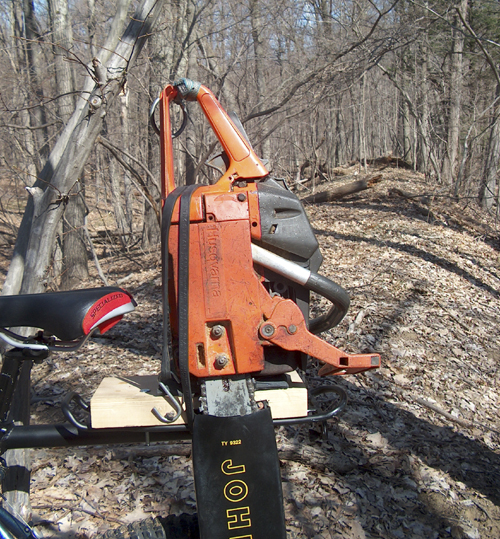

I mountain bike and some times a big tree will fall way out in the woods and it is a pita to hike a heavy messy gas chainsaw way out there to cut it out. Most of the time we just build ramp over the log or re-route the trail around it but it would be nice to have a light chainsaw I could throw in a backpack and ride out there to it for those that really need cut out. All the reviews talk about cutting a bunch of 5" limbs but I carry a handsaw for smaller stuff like that. I don't need to cut twenty big trees down just maybe one or two cuts in a big tree so I can roll it out of the way. Just wondering if one of these would cut it ;).
