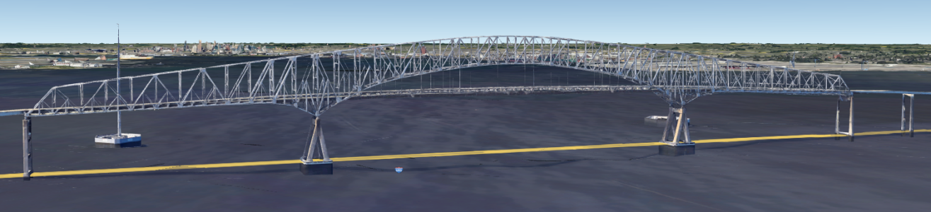

Just glancing at the site you'd need something about the size of the Verrazano which wile doable certainly would have cost a hell of a lot more than a suitable truss bridge.
truss bridge cannot span 366m
73,399
34,980
It's an interesting design with the central truss arch with roadway suspended beneath. I suspect the engineers were given direction to build the cheapest possible bridge that would allow ships to pass.

umm whut? it's 2,600m long, with the longest span being 366m. what kind of bridge do you envision they could have built in the 70s? Also, the water is about 15m deep near the bridge.
makes more sense to protect bridge supports.
I was trying to decide if you were serious or joking. The Golden Gate Bridge was built in 1937 and has a span between towers of 4,200ft. The total length of the bridge that collapsed is 8600ft and of that 1200ft is the longest span in that tangled mess of steel. There are two sections in that bridge for about 2,400 feet that have a joining span in the middle. The rest of the bridge is like a concrete causeway similar to what they have in Florida.
The longest span between support towers on a suspension bridge is 2023m or 6637ft.
There is more than enough space for a suspension bridge making it impossible for a cargo ship or cruise ship to impact the bridge. A clearance of 225ft above the waterline would be best because they keep building bigger and taller boats.

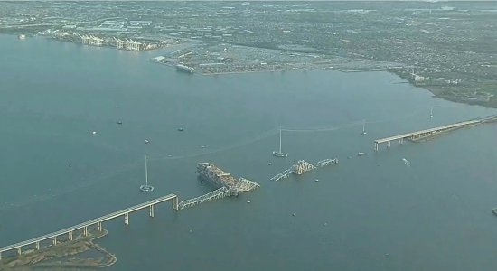

Not a civil engineer but I imagine 95k tonne doesn't stop on a dime. Apparently it was doing 9 knots, that is a lot of momentum.

A tunnel would be the best option. I only pointed out a suspension bridge would be a better option because the support columns could be on land nowhere near a ship on the water.
