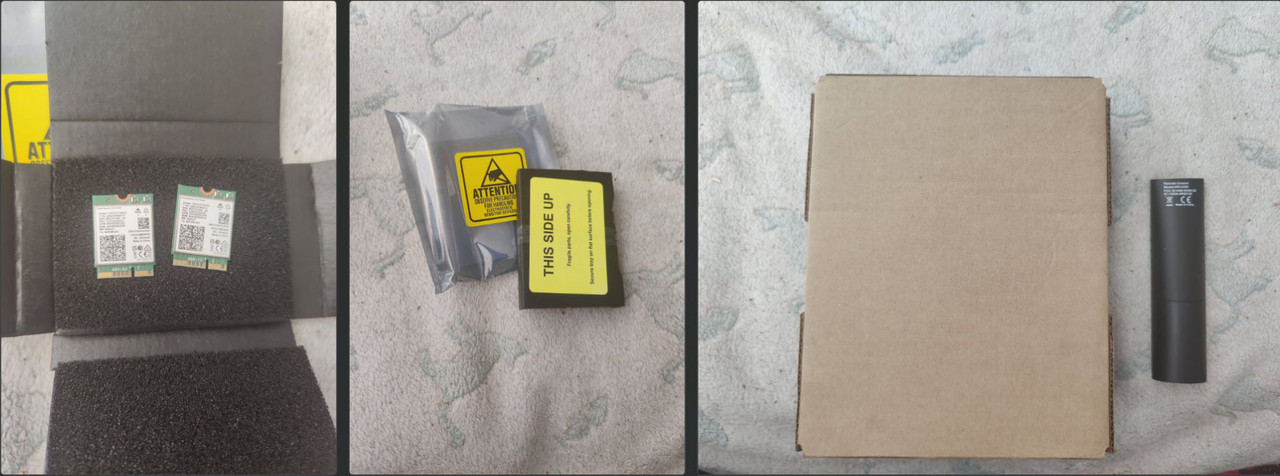

Well, the 2nd order showed up on time as scheduled surprisingly.
The packaging is nice to see they aren't cheap like Amazon and just throwing things in a plastic bag and heat sealing it. They used a decent size box so it doesn't disappear into the mix with sorting which makes me question how UPS managed to F up the first delivery so badly and send it to CA. I half expected to have this show up in some odd sized packaging that would allow it to be diverted easily w/o noticing it around another package but, that's not the case here.
