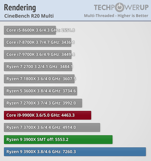

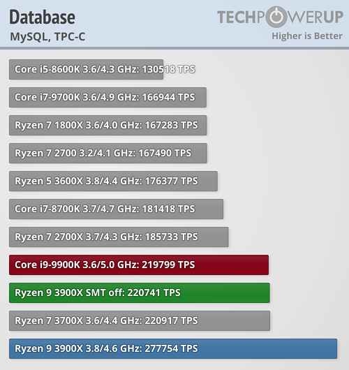

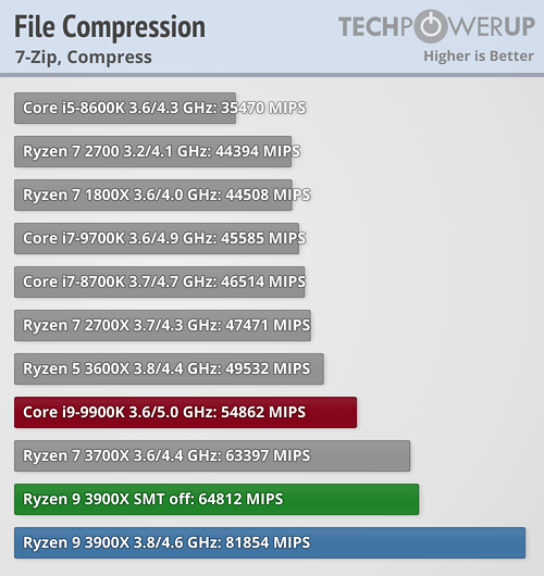

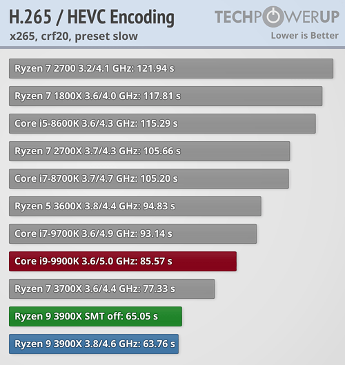

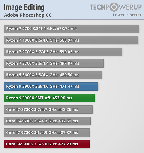

There are bunch of test on internet regarding SMT benefits on Ryzen, clearly showing Zen2 SMT benefit is about 25% in average. Intels HT is about 20%.
CB20 SMT benefit is 31%
Photoshop................ -4%
Database................. 26%
7-zip ........................ 26%
H265 ......................... 2%
TechPowerUp average ... 10.5% .............. Please show me your 66% SMT benefit at some representative web reviews.
HINT: Take a look at Photoshop CC how close 3600X is to 3900X SMT Off. Is it due to bad MT scaling which show negative -4% SMT benefit at 3900X or because SMT brings 96% benefit on 3600X vs. 3900X? Do you see how stupid and wrong is your calculation?

Do not do your crazy calculations about SMT benefits any more, please.
Photoshop................ 6%

Did you not read my post on how I determined whether I included a benchmark or not? If a benchmark doesn't scale up with addition of PHYSICAL cores, then it is lightly-threaded or heavily dependent on ST. I outlined ALL of that in another post. Photoshop is one such test - very dependent on single-thread performance and so it's a TERRIBLE test to use when considering whether SMT is beneficial. If you cannot see the logic in what I just said and what was in the other post, you have no reason to be commenting on this issue at all, period.
Comparing two different CPUs to find out SMT benefits is invalid. More poor MT scaling application has (every application has different Amdahl's law hit), the bigger number your calculation shows (because 3600X is geting closer to 3900X). But that's due to poor MT scaling not because SMT is soo good. Jeeez. That's completely mathematically invalid.
Please post here some graphs from reviews showing similar 66% SMT benefits you claiming here. I posted graphs from a review proving I'm right and your calculation is wrong.
I'm sorry, is this what you were looking for?
So you want to prove Zen2's 66% SMT2 benefit by posting results of ThunderX3 SMT4. Like..... really? :D:D:D
