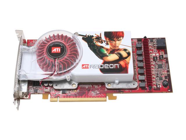

IIRC, the maroon heatsink on the end of the ATI card also gets in the way of the nV Silencer. The Silencer almost fits, but really it doesn't...
The grey base on the ATI cooler is metal btw, not plastic.. At least mine were metal on my X1800XT and the two X1900XTX's I've owned.
edit: newegg pic added for reference to both points:
http://images10.newegg.com/NeweggImage/productimage/14-102-676-03.JPG

the silencer looks like it will have enough clearance in regards to the red mofset heatsink. i will check it out tonight when i get home.
I see what you mean. Some OCZ BGA Ramsinks might be able to solve that however, since they have a pretty low profile.
