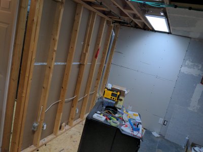

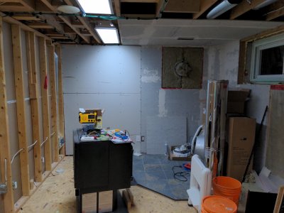

More progress on my drywall today. Had to reroute a few cables first, trying to reduce the amount of areas cables come out of just so I can centralize the exits. So that took a bit of time. Taking a wine break then will go hang one last sheet and one inside wall will be officially done. The hardest one. Rest will get easier from this point on.
All this so I can move my firewood indoors. That's really what prompted this since the location I want to put it is right up against the server room wall and I knew this had to be done anyway so made sense to do it first.
Still debating on how I finish the inside of the server room. I can try to do a good job plastering so I hardly need to sand, or I can put some kind of border at all the seams and call it good. I'm kinda tempted to just plaster it and hope for the best. It doesn't need to look super good in there I just want it at least semi finished. Ceiling will stay open, no point in covering it as it will be a pain to run wires.

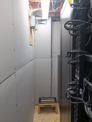

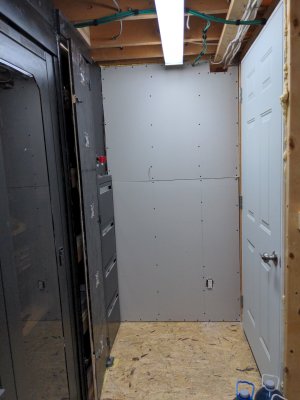

Done for today, getting there. Hardest part is done I'd say. Working on the hot aisle side and even the cold aisle wall was tricky. The other inside walls will be a bit easier, and the outside walls will be easy too. Just a lot of outlets to cut in... I went a little overboard with those.

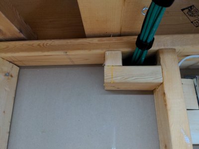

Rerouted a few data cables today too just to minimize wall penitrations and setup a "duct" for power and one for data. There's a few wires I just left and cut in anyway, they'll be caulked in and will not run anymore through there. The ducts will be for future runs. I'll just stuff a garbage bag in there or something. Goal is to make the room as air tight as possible since cold air will be forced in and the hot air will ideally go down that duct and into wood stove room. May as well just put all the heat in one place. :p There will be a 6' duct in that room that will either connect to furnace or just dump the air into crawlspace, have not decided yet.
