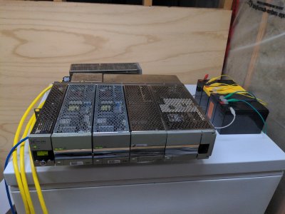

Found 4 old gel cells to make a crude 48v bank. These batteries are dead/semi dead ones that I just never recycled. They still hold enough charge to test my rectifier shelf.
I'm actually starting to think I can probably script my alarms through telnet instead of the relay outputs. Just need to do a get system info and grep the info. Get voltage, current, and alarms all in one screen. Can probably use a python script to do it.
Been tweaking alarm thresholds, but I'll probably play with this more once it's live.
Running off the batteries now and watching the voltage go down. No load though.

Should have a LVD warning alarm at around 47.9 volts. At 46 it will actually disconnect the battery, killing all power to the system and any loads that would normally be attached. This is great as I don't have to worry about over discharging the batteries. I figured the way these worked is you just have a single output but there's actually a battery side and load side, so that gives you more flexibility.
It came with only one 100a breaker though so just ordered 2 more. 2 for the battery side (2 strings) and 1 for load side. There's also a 30a that I might use for a single inverter. Really as is, I'm practically ready to deploy this as if I hard wire everything I will still have circuit protection anyway. I don't need to do the bus bar right away, only once I add more inverters.

The web interface would be nice and all but won't really need it, so glad it has telnet as it would be a headache without it. Bonus that I found the doc for it too.

And there's the LVD alarm as voltage dropped past threshold.

I think that's enough messing with my rectifiers for today lol. I actually wanted to put some more work on the basement today and kind of got side tracked.
I think I have everything I want figured out though, such as low voltage disconnect and the alarm relay outputs and stuff.
