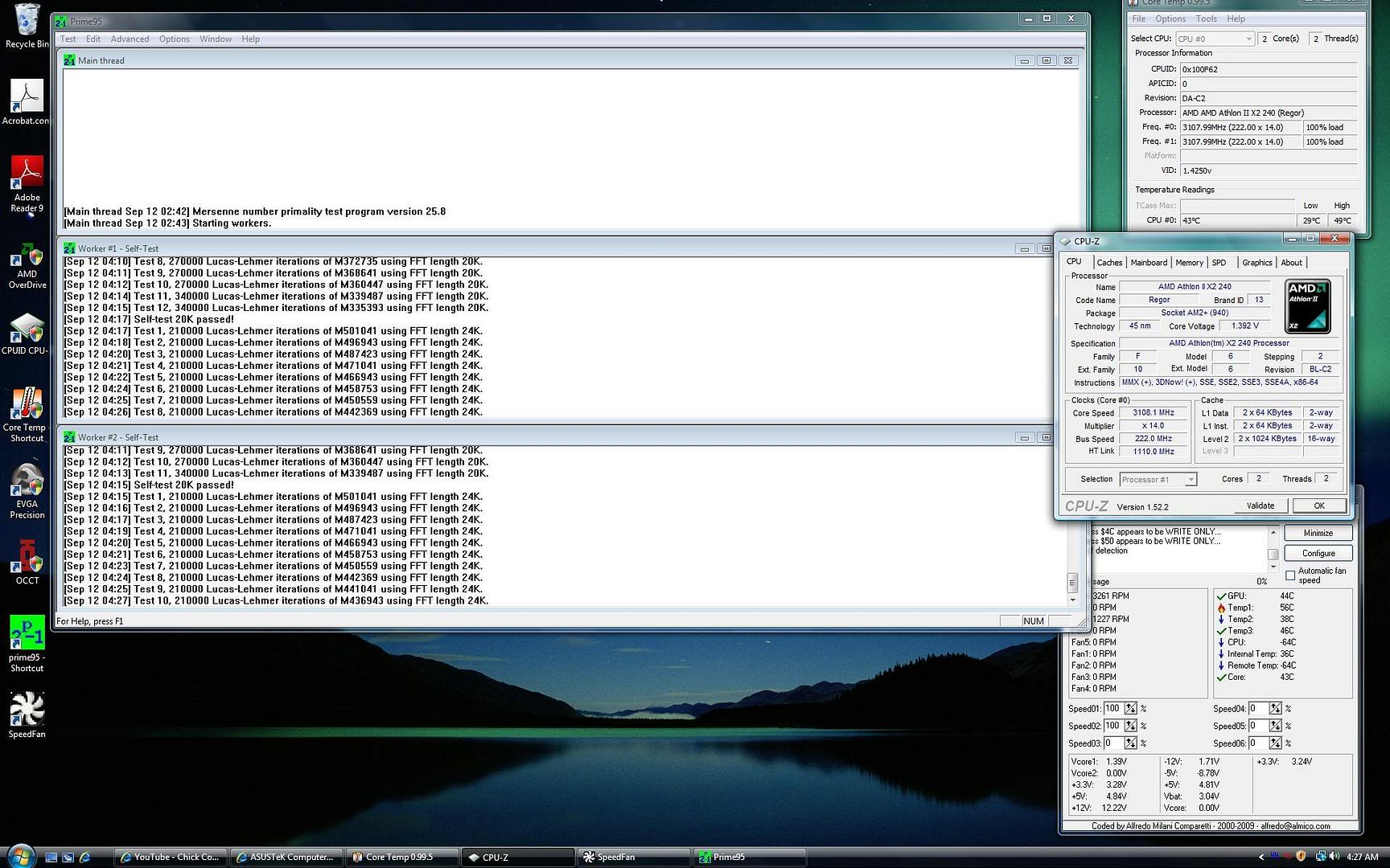

I got that cpu to use with my old motherboard, the Asus M2N32-SLI Deluxe. While i am happy that it runs on that board i just cant get it to overclock decently. The max I can get it up to is 3.1 ghz and even then i am having problems keeping that baby stable. I dont know about you guys but i cant set the multiplier any higher than 14x.

byteman99 14 is as high as the multi goes on the 240,it sounds like your mobo or ram is holding you back,What memory are you using?

I am using a 2GB stick of g-skill memory. And the mobo im using is the one i posted earlier.

You were right. The RAM was holding me back. I lowered the speed of the RAM to DDR2 667 speed and I was able to get a bit further than yesterday. I was able to push the frequency speed all the way up to 260 this time. But the computer would crash 2-3 minutes into running Prime95. Right now im working on getting this thing stable.

Looks like I hit the wall with this cpu. The highest frequency it will load into windows is at 263. After that it just wont boot. This is with the v-core set to 1.5v. I suppose i could go higher but i dont feel like its worth the risk. Now i just have to work on stabilizing it.

After a couple of days of tinkering with this cpu i got it up to 3.5ghz stable. Im pretty satisfied i was able to do this with an older motherboard.

From what I've read over on the Asus forums, it is because your BIOS doesn't recognize the CPU, so it doesn't know that it should enable the extra power phases of the motherboard. So, your processor is basically power starved and/or isn't receiving clean power.
People who have spoken with Asus technical support have reported back that Asus has no plans to give official support to AM3 processors, so whatever you get above stock is a wonder in itself.
