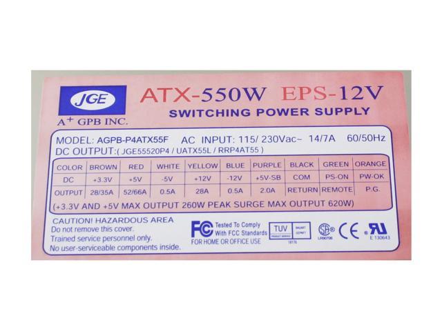

p.s. Those Athena PSUs may actually be made by a PSU maker with a better-known rep. Look up the UL file number (e.g. E123456), if there is one, to find out. If there is no UL/RU mark and no file no., then that would be reason enough for me to stay away.bh.
. Looks like there are at least two mfrs that actually make the Athena PSUs. One appears to be JGE (never heard of). The UL file numbers in the pix I've seen are too small to read and too fuzzy to read when enlarged.

I have a 500W made by A+GPB (Athena). The power supply I have is meant for dual processors. For over two years, I have had no problems with it. It has 28A on the 12volt rail. It's been a solid power supply so far.
